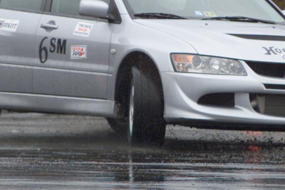

The RRE Eclipse uses Hoosier 245/40's on 8" rims....we all know that Hoosiers are actually wider than their stated width. So if RRE gets the superb handling and is comfortable using that wide of a tire on an 8" rim for track days...everyone should be plenty comfortable running a similar width tire on the street...keep in mind a 245 series Hoosier is probably more like a 255-265 when compared to a normal tire.
Here's a 245/40R17 Hoosier on a 8" rim. Superb grip and handling when dry -- makes the A046 look like a poser. Not so good in the rain.
