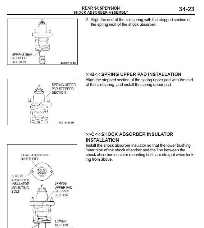

I just installed swift spec Rs on my evo and like an idiot I didn't pay attention to the lower rear spring perch orientation. I have done a lot of searching and I have found some vague references that the spring ends should both be facing the rear of the car. Is this correct?

Sorry, didnt catch this post earlier. The rear perch has an spring end indentation for proper clocking of the spring
Didnt read anything that noted which direction the perch must face
See attached image

As long as the spring is fully seated on the perch you'll be fine. Whether the spring is facing the front or the back in the rear makes no difference whatsoever.
