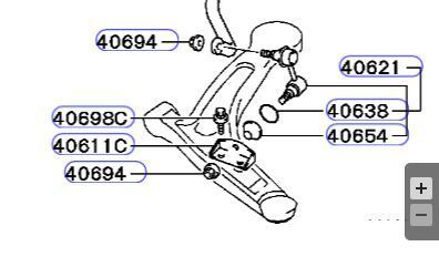

Anyone know what the part # of the bolt that attaches the front sway bar to the lower control arm??? I broke it inside the LCA and need to buy a new bolt. I can't seem to find it anywhere. Its in the image # 40698c

40698c Tranlates to part no. MF241282 (M10x25). Always double check before ordering!

MF241282 is what I pulled up so that is the exact part number. Otherwise, if you're feeling cheap, the bolt is an M10x1.25 25.
