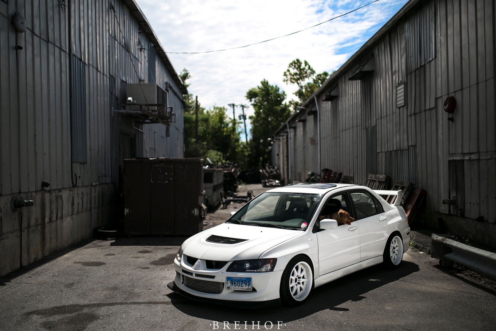

I'm running 17x9.5 +17 on my Work Emotion wheels. I'm also trying to sell them if you're every interested. Comes with new tires with 1k miles on them.
Old Jul 1, 2016 | 02:06 PM
^^^Hey Erik. We meet again LOL
What tires are mounted & let us know what rear fender work has been done (any rear rub at all)?
