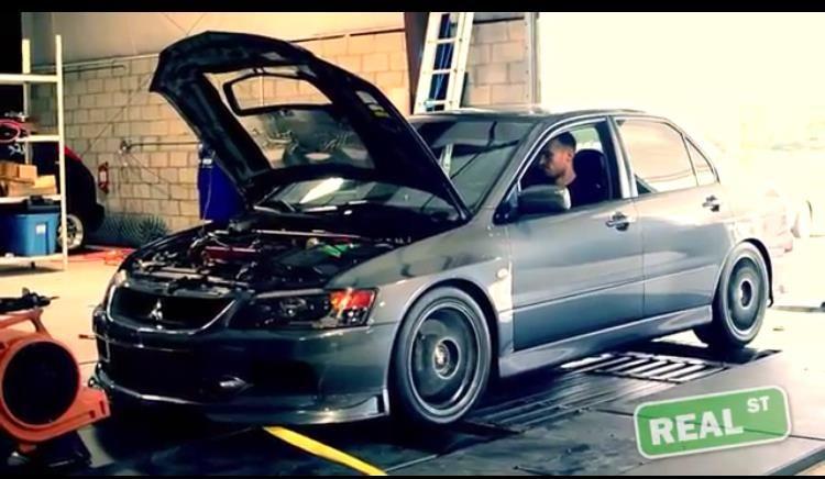

Working at Real Street I have access to a dyno and spent some time with Jay( he's tuned dozens of cars on AEM,Haltech and MoTec) and we both worked thru ecuflash/evoscan for the first time. It wasn't that hard and it was the only car he's worked with. He still preferred a standalone but the stock ecu would work for the time being.
Baseline was 250/250 on the dynojet on August 1st 2012 19psi and falling.
August 3rd 2012
Added Full Tomei Ti Exhaust including 02 housing and DP and lost 50lbs and picked up close to 50WHP/50tq on the same stock tune.Around this time a Walbro 255 went in

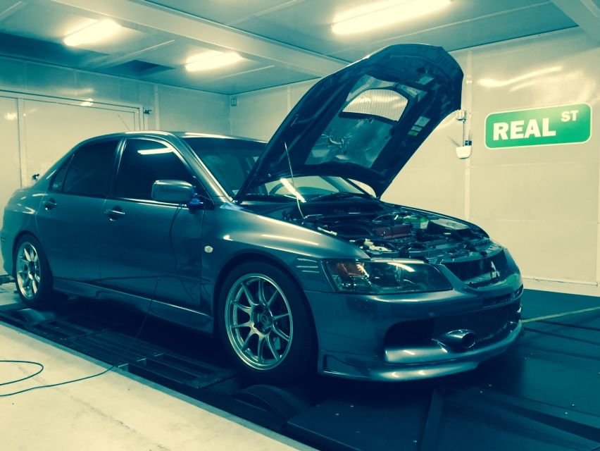

I've had an RSP 2.2 fully built for 6 months waiting to go in. The WannaGoFast Ocala event is in Jan 2016 so I wanted to turn the power up and shift it into 5th . Since the stock engine with stock cams was coming out I told Jay to not worry about keeping the torque down.
93K Dec 2nd/ 3rd 2015
The car has been at 500/400 for a year
So it was turned up and made 540/405 24-32psi
We also made 573whp/449wtq running 26-34ish psi
It was making power really well and there was no knock. The Infinity with a COP system can see each cylinder and trim timing per cylinder and can also add/subtract fuel if needed. I decided that was enough
for that day.
I ran the car a few times that night and it was clean and pulled really well. I decided I wanted to shoot for a stock engine/cams/red record so we strapped it to the dyno once again on Dec 3rd around 11.
The engine responded well with more boost so we kept going . The conditions were great.
589whp/456wtq running 26-36ish .
I hadn't seen a car make that power with my combo so I wanted just one more run.
615whp/477wtq ramping boost from 30-39psi was the final result.

Ran it on thee dyno in 77* and humid weather on more boost. 649.64/530.97 smoothing 0.
