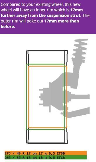

Here a visual for you. 18x9.5 +35 running a 265/35 tire (22mm spacer added) compared to what I run 17x9.5 +30 running a 275/40 tire
The +13 wheel pokes out another 17mm / .66" (took a lot of work to fit my setup. Imagine trying to fit a wheel .66" further outboard?
