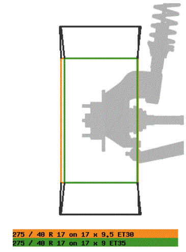

I ran the this on the calcu, comparing my setup to your proposal. You will likely need more than a roll (maybe a super flat roll (paint crack) & the bumper bolt relocation)
Ive run a 275 on a 9" wheel & it fit ok, with not too much side wall bulge
Heres a pic of my ride w/the Fed 595 EvO 265/40 mounted on 17x9.5 +30 (my rears are pulled, rolled, bumper bolt relocation & the bumper cover skirt pulled out 1")
