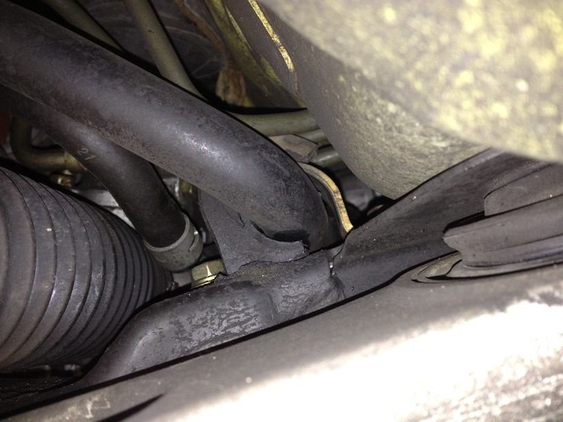

I tried searching but got no luck. Has anyone tried replacing the front sway bar bushing without dropping the front crossmember. I know you have to drop the crossmember if you want to change the front sway bar, but I was just wanting to know if its possible to change it out without going through the hassle if not needed. Thank in advance

I did it just from disconnecting the 2 bolts from the bracket holding the bushing on. Only a little annoying reassembling but still pretty easy.

When I did it, access was pretty tight. I did end up loosening the bolts for the crossmember, to get a little more clearance.

To shadow what others said I too was able to replace the bushing fairly painlessly without dropping the subframe. Took less than 15 minutes all said and done easy peasy! Good luck!
