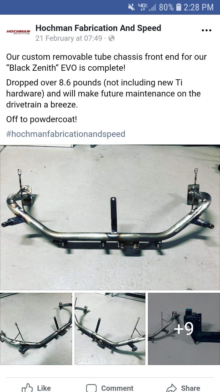

Hochman Fabrication in IL is releasing tubular front end kits for EVO 8/9's that retain mounting points for the cross member, FMIC, headlights, ETC. Some decent weight saved there.
Just looked them up. Looks like a nice piece. They're local to me so might hit them up about seeing if they want to make a full removable front end. That piece would be 36 times more appealing if the top part of the core support came out too since that would allow engine removal/install through the front of the car.

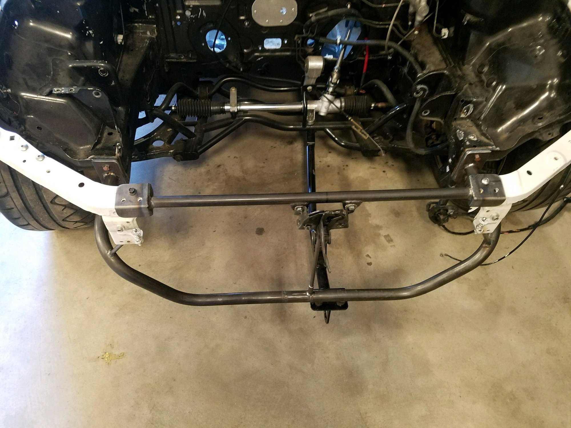

That's how i'm building mine. The lower is permanent however the upper will be removable with Moroso quick release pins. It's nice pulling the motor out the front for sure.
