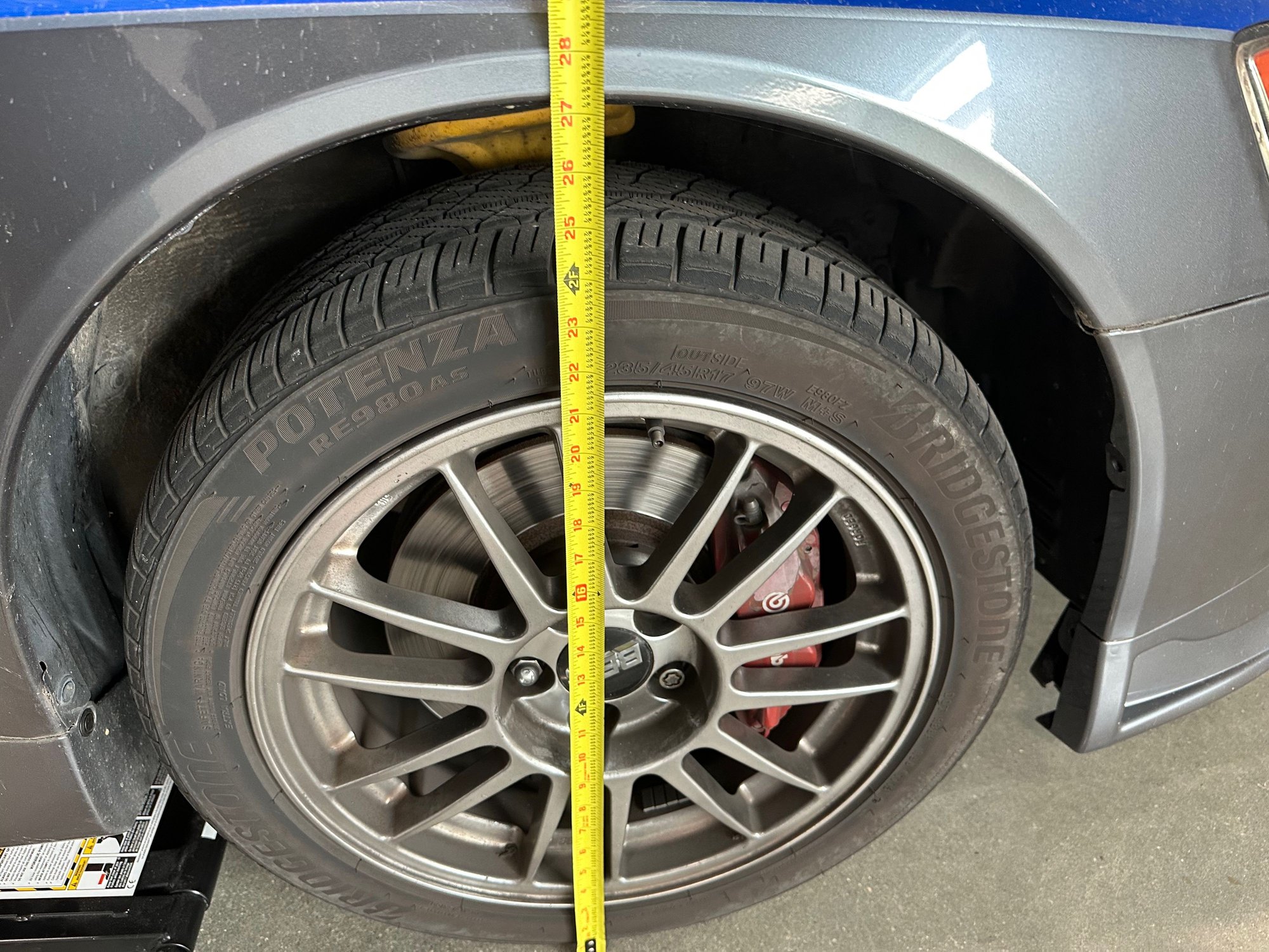

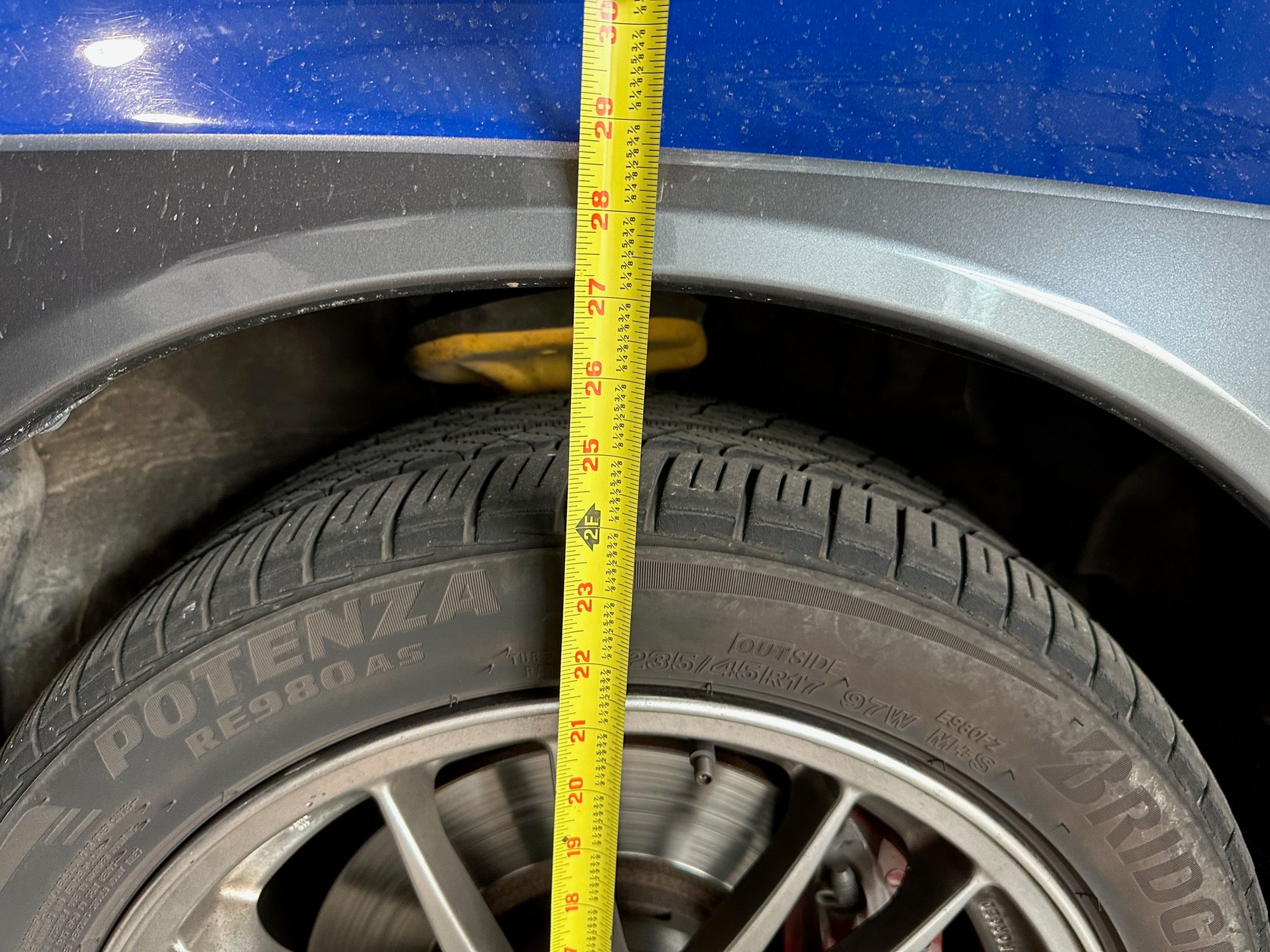

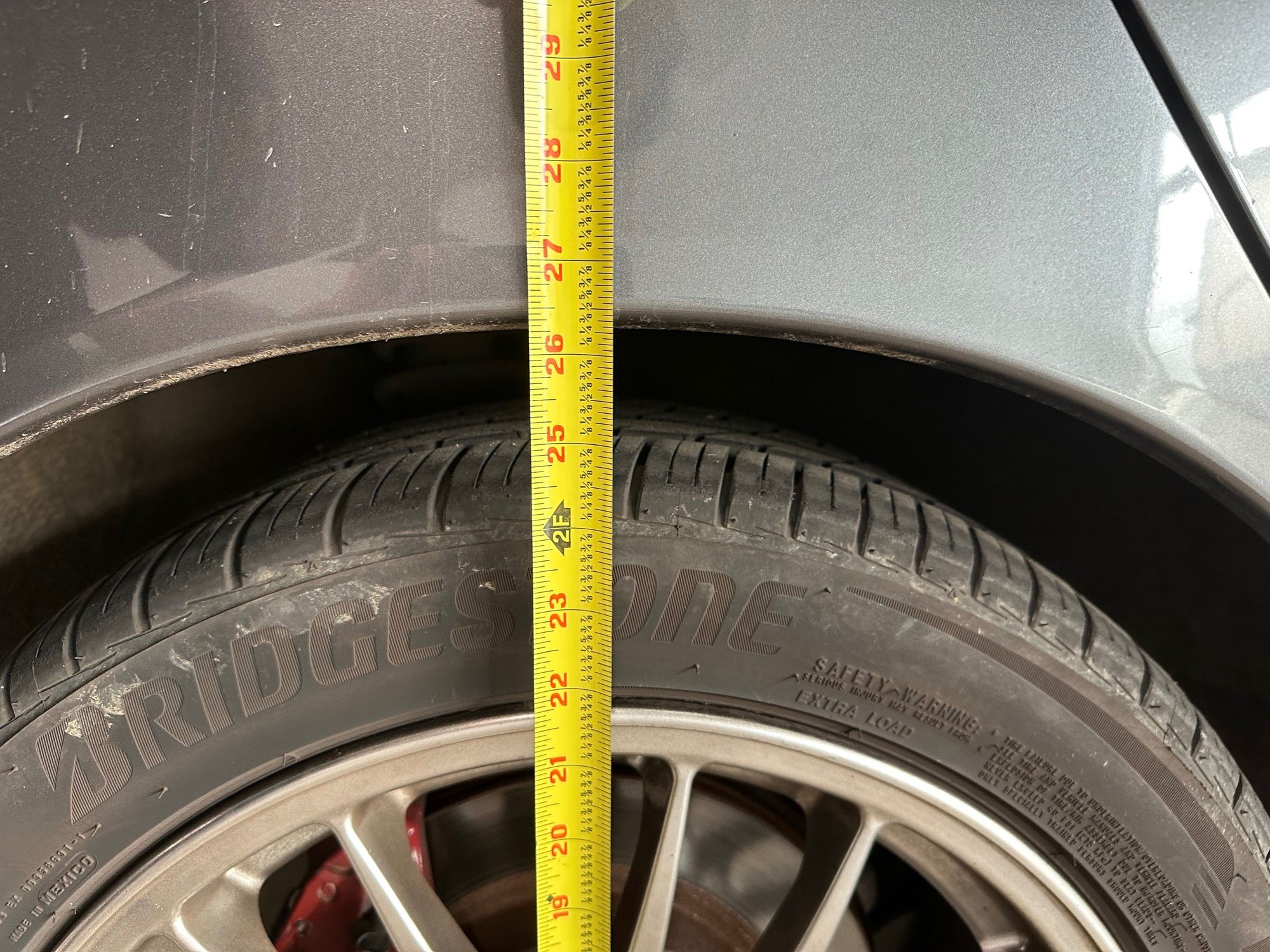

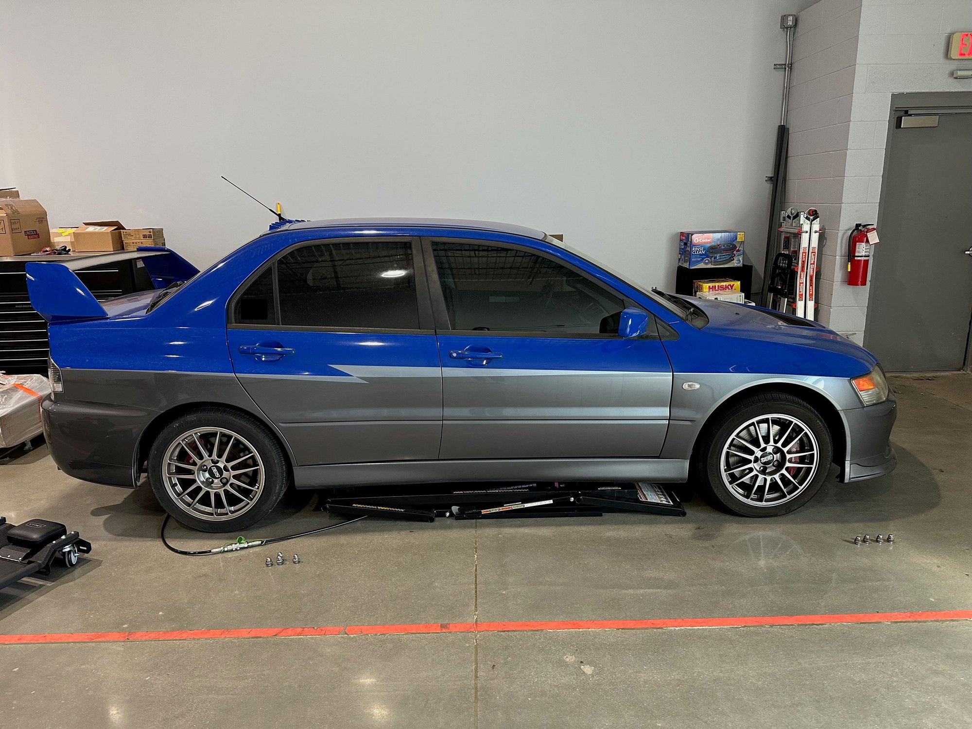

Old Apr 8, 2025 | 10:48 PM
rustykan's Avatar
5 Year Member
Joined: Aug 2020
Posts: 80
Likes: 60
Front
Front
Front up close
Front up close
Rear
Rear
Rear up close
Rear up close
These are pictures I took of my Evo 9 MR on stock suspension and wheels with 235/45/17 tires. The front fenders are just under 27.25" and the rears are just over 26.25".
