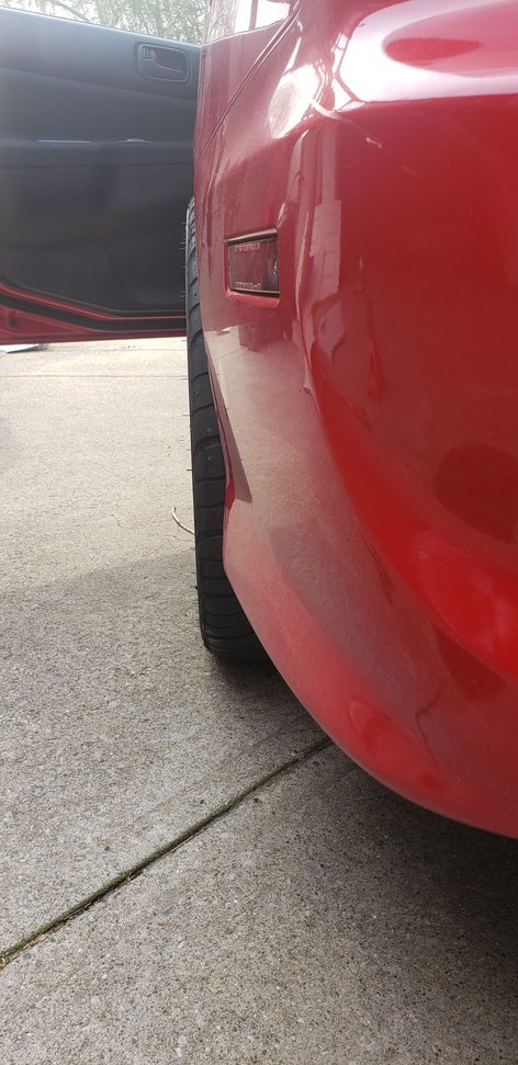

Well, i got the tires mounted and they do rub on tighter turns in the rear the fronts only rub at full lock which i expected. What can i do to fix the rub in the rear
ive read about the bumper bolt relocation and i can't seem to find a thread that shows the bolt it's talking about

Old May 1, 2020 | 06:49 PM
Can you add a pic or 2 of the setup? A side pic looking at the tire as it sits in the rear well
Heres a pic of my bumper bolt relocation. Its a very simple concept.
I recommend you disconnect one of the rear struts & disconnect one side of the sway bar & cycle the rear susp as noted above.
Old May 2, 2020 | 07:50 AM
Immuneevo's Avatar
Joined: Jul 2018
Posts: 72
From: Cleveland
Here is my rear fitment. The fronts im fine with they rub on full lock and thats it
Old May 2, 2020 | 10:36 AM
Cant tell from that angle. The pic should be looking from the top down or from the rear looking fwd, so we can see the wheel & tire poke
