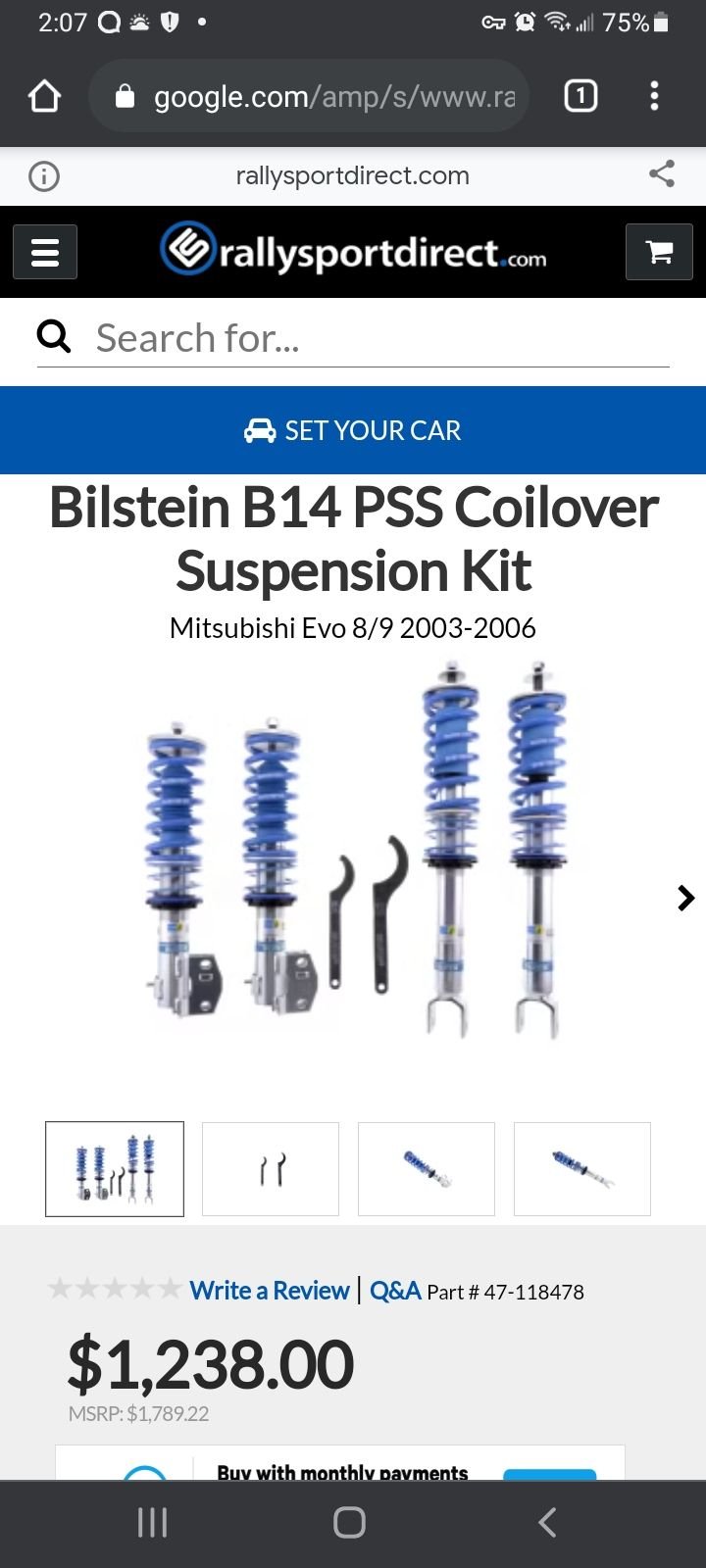

Hey guys, I've looking at threads regarding coil overs and there seems to be about 2 or 3 brands that are most popular with everyoneon this site. I found some Bilstein adjustables that apparently don't require any camber or caster adjustment. I was just wondering if anyone has heard of this setup or possibly running this setup.

I looked them up & the springs rates are not noted. Most of us would tell you to choose something where you can call out your own spring rates based on how your EvO is operated

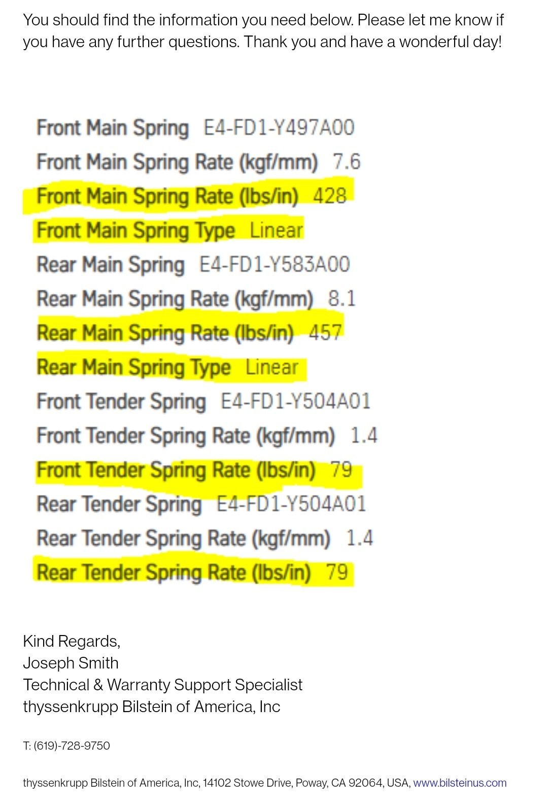

I emailed Bilstein for the spring rates on their B16 PSS9 Evo 8/9 coilover kit...unless you get them for under $2000 the Ohlins R/T Kit is still better since it has a stiffer spring rate.

Good info, thanks for your help. I definitely do not want a stiffer ride, the OEM suspension is stiff enough. I'll check out the Ohlins.
