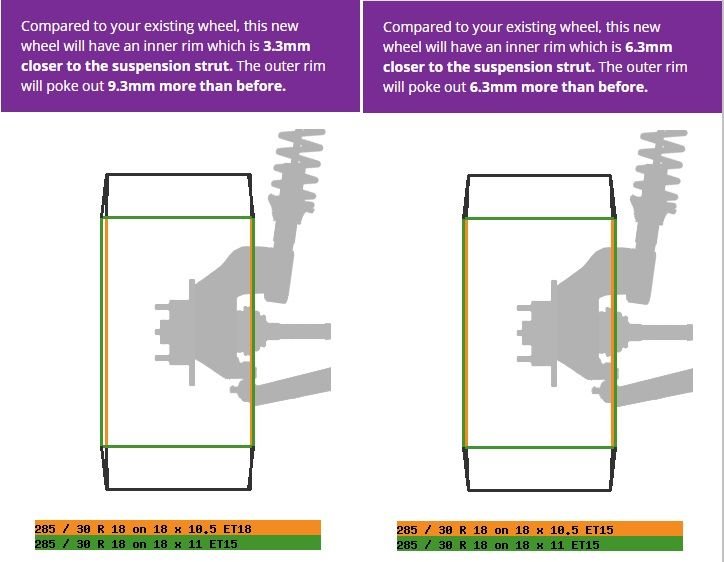

I've had 2 setups where I got lucky enough I didnt need spacers. Hypergrams 18x11 ET15 front, ET40 rear, 295 A052s. but this is not for everyone and needs several mods to fit. I've had several RPF1s and that was a long time back but IIRC my 17x10s with different offsets didnt need spacers.
anyway, what you need is a good baseline (what you have) and start using willtheyfit.com
I'm just showing how helpful this tools is
