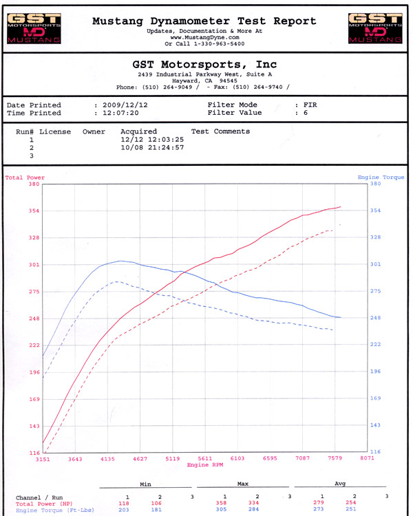

This car came back in for a quick retune after installing some additional breathing mods.
This is a great before/after study to show how proper flow mods can really help power/spool/response.
Originally this car was built to be super super stealth. Read more about that here:
https://www.evolutionm.net/forums/ev...-10-fpred.html
After adding an aftermarket catback, FMIC and UICP it came back in to get retuned.
2008 Evo 10
Mods:
RRE stealth catback (was stock catback with modded internals before)
AMS downpipe
GST testpipe
FPred @ 24.5psi across
AMS FMIC
Nisei UICP
DW 1000cc injectors
Drop-in air filter with stock airbox
GST Boost pill
GST Custom dyno tune (ecuflash)
91 oct
Great gains everywhere. Notice how much better the car spools now with it uncorked. This is a track car so the tune is a tad tamer than a normal street tune.
This Evo 10 is now making inline with what FPreds make on Evo 8/9's on our dyno but with less mods then the Evo 8/9's (which would have cams, intake, etc).
358 whp / 305 wtq
Boost plot:
For reference with our dyno:
Stock 03/04 evo = 190-210whp
Stock 05 evo = 210-215whp
Stock 06 evo = 220-230whp
Stock 08 evo = 215-230whp
Stock 09 Ralliart = 190-199whp

Nice work as always Bryan. Thanks for providing a good amount of information in all of your threads. It eliminates a lot of questions and keeps the thread on topic. Thanks for sharing.

awesome comparo! Would have been really cool to see this on the stock FMIC, I imagine the biggest gains are from the catback. FMIC is a must though if this thing sees track time!

How much different would the HP and Torque numbers be if this was not a track car?

Probably run a little more boost, leaner AFR and more timing. maybe another 15whp overall.
Again, this is inline with what more modified Evo 8/9's with FPreds have done on our dyno.
