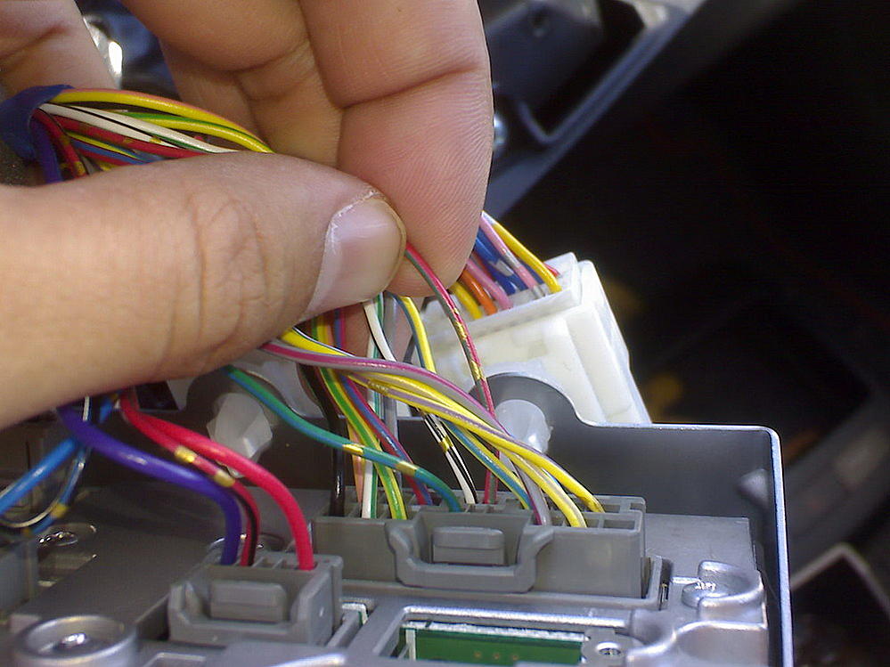

If you disable the GPS you'll be able to play videos from your iPod and the japanese chat will stop.
Cut the red/green wire as shown in the attached picture.
Best thing is to replace the unit with something else and get a Trinidad GPS separately.
I just got a JVC KW-AVX 720 from Amazon and it looks fine.
thanks man...
