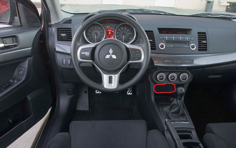

Btw. Where is your oem audio jack located?
Got a pic?

its in the area i circled in red. thats just a pic i found online, don't have a pic of mine...
