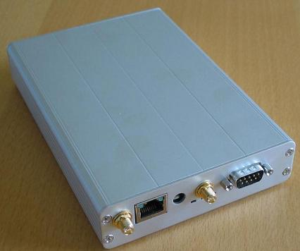

Or you can use Linux.
I have one of these that boots in 10 seconds from receiving VCC. (from a stock Slackware Linux install it was about 2.5 minutes before I went to work optimizing everything under the sun)
500mhz AMD Geode x86 CPU.
256mb ram
compact flash slot on the board for the OS (using an old 256mb card myself)
Pic here(http://www.wifibot.com/attachments/I...lix_board1.jpg)
I customized Slackware Linux and manually rewrote the boot init system. Custom compiled the kernel removing module support and only compiling the exact hardware drivers it needs. Even though it's a compact flash card from the late 90's (horribly slow), it's still OpenGL ready and fully booted after 10 seconds. With a real harddrive I bet 5 seconds is achievable.
If you get one let me know and I'll DD the flash ROM and share it up. Just needs someone to write a front end because I never got around to it. Lost interest after selling my IX. I may pick it up again one of these days after I finish some other side projects. Obviously linux lacks EcuFlash/Evoscan support but the OP2.0 standalone logging is all I use anyways these days. I use an EEEPC running XP to flash.
Anyways your install looks good. Props!
