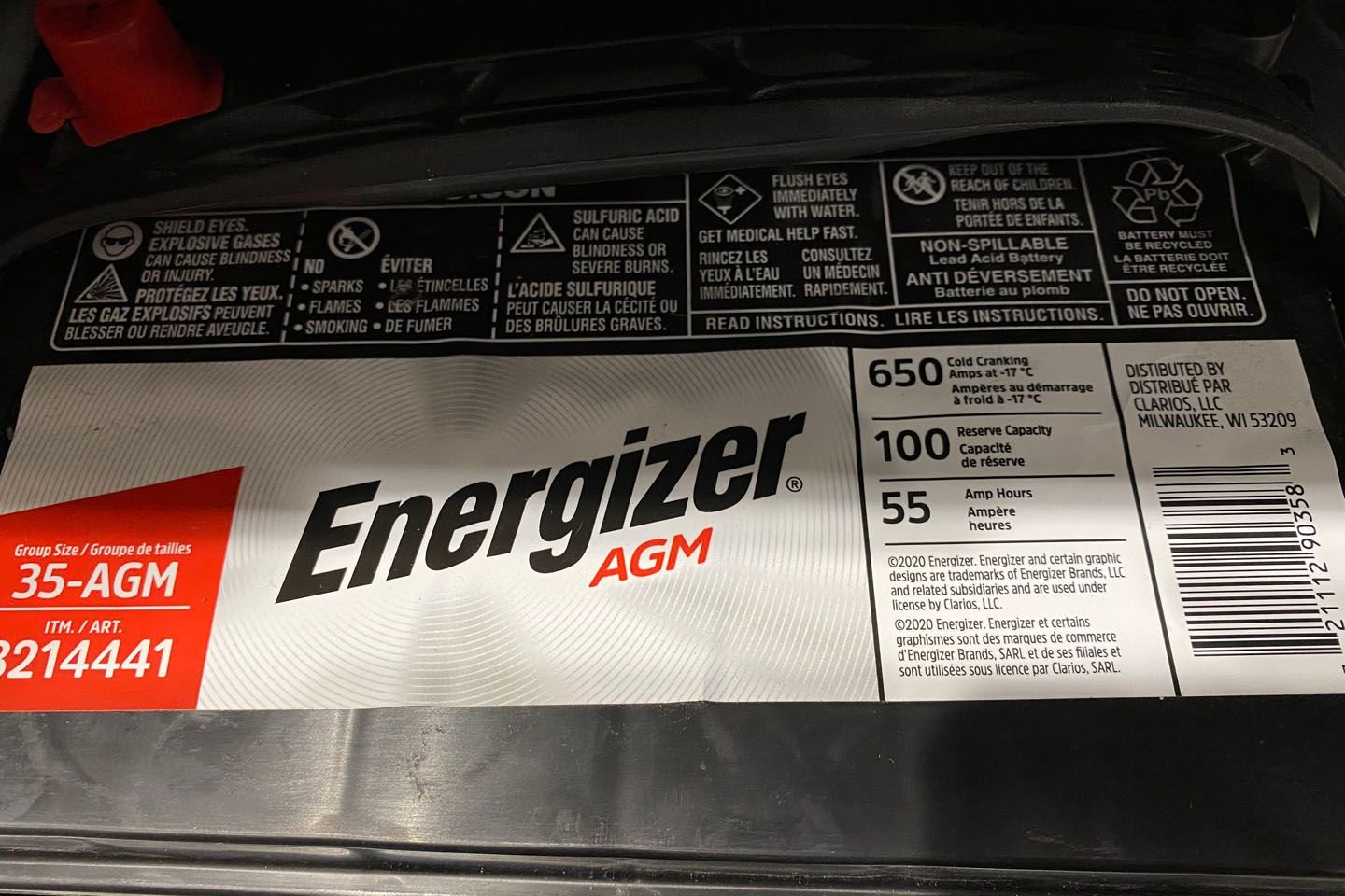

Afterlight
The X2Power AGM battery is going out after 3 years. It struggles to start the engine in cold winters. In hindsight, the X2Power/NorthStar battery is still the best and most durable aftermarket AGM battery I've ever had.
I'm replacing it with an Energizer AGM battery. It's more available in my area (in-stock and off the shelf) and supposedly has a better warranty. That said, it might not last as long as the X2Power one. We will see.
X2Power (on a shopping cart) on the way to recycling.
Energizer AGM battery (Group 35).
Energizer AGM battery (Group 35) installed in Evo X.
