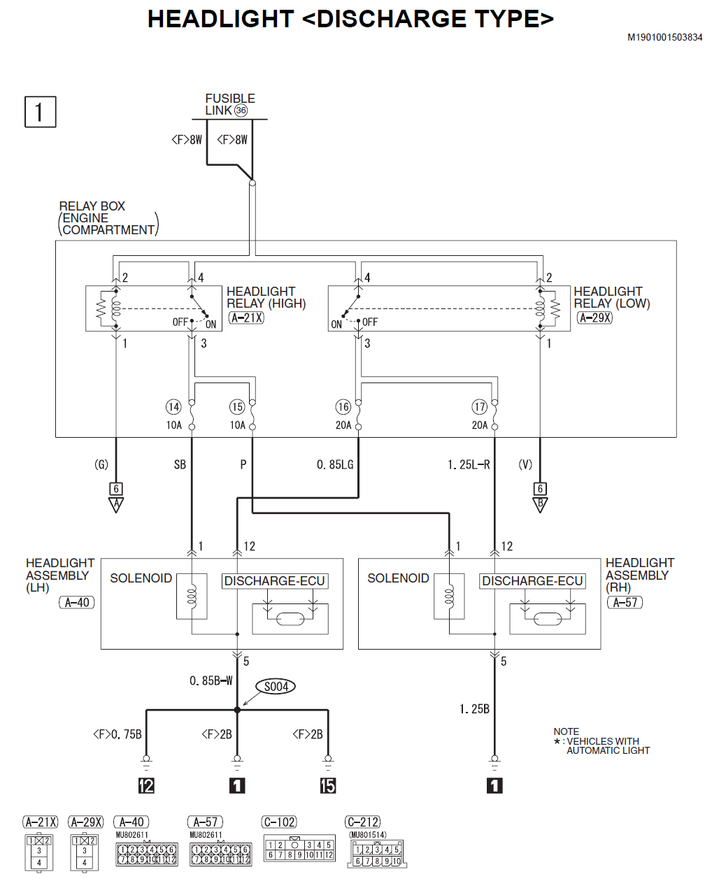

Please help or point me in the right direction. I hit a deer and decided to buy vland lights going to put oem ballast in but dont know where to hook the ground that cam off oem projector. That's just the start can anyone help me get these lights wired correctly. I'm extremely capable but I cant find the pin out that I need or know exactly what wires on vland need juice from wire on harness. If anyone can help please take couple minutes to write something. I got to have this ready for body shop would kill me to miss the entire pa carshow season

Here's the best thread I could find on it. Most of what I've read is that you're going to have an error message about the leveling system, that there are issues with the DRLs, and that it's not plug and play.
So much is run through ECUs these days, it makes modding harder than ever!

Thanks for the reply. I've got most the pins switched around only couple of wires left I question. Waiting to see if vland will email a wire diagram tomorrow. If I pull it off I'll definitely make a post on how I wired them.
