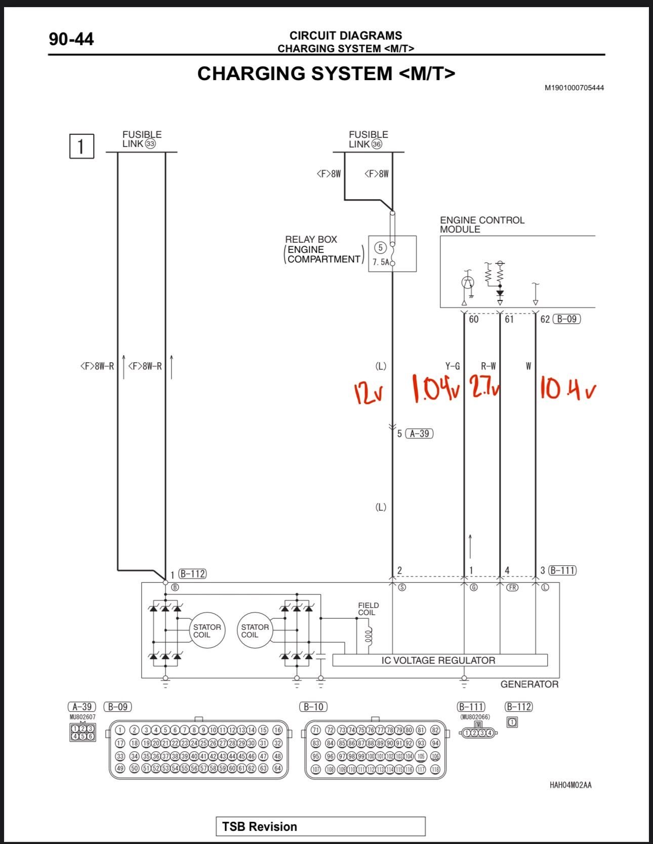

Hi,
I need a little guidance as I’m not sure what else to check for my car. I have a 2014 EVO X GSR and I am having issues with my charging system. I replaced alternator went out on me so I replaced it with 2 different rebuilt Autozone alternator and I just assumed they were both defective as I’ve heard a ton of stories.
So I ended up getting a 3rd on from my buddy that is OEM and for sure working but I am still not getting any and voltage really from alternator output. I am only getting roughly 2 volts from alternator output. So I started testing the pins that connect to the alternator that come from ECM and without the connector plugged into alternator I am getting. RW: 10.7v
W: 11.4v
YG: 0.02
But when I test the cable when the connected is plugged into the alternator I am getting
RW: 2.7v
W: 10.4v
YG: 1.04v
I have checked the positive wire coming from battery to the front and I see nothing touching it or messing with it and as far as I am aware everything is grounded correctly. And the alternator fuse is perfectly fine. I have checked and relays yet
