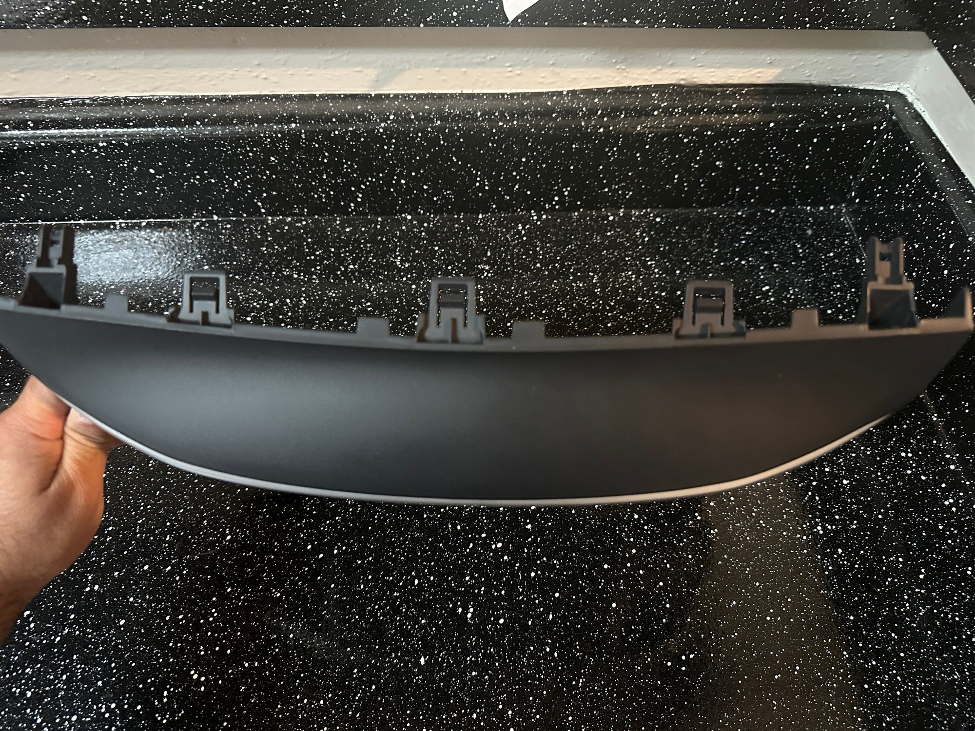

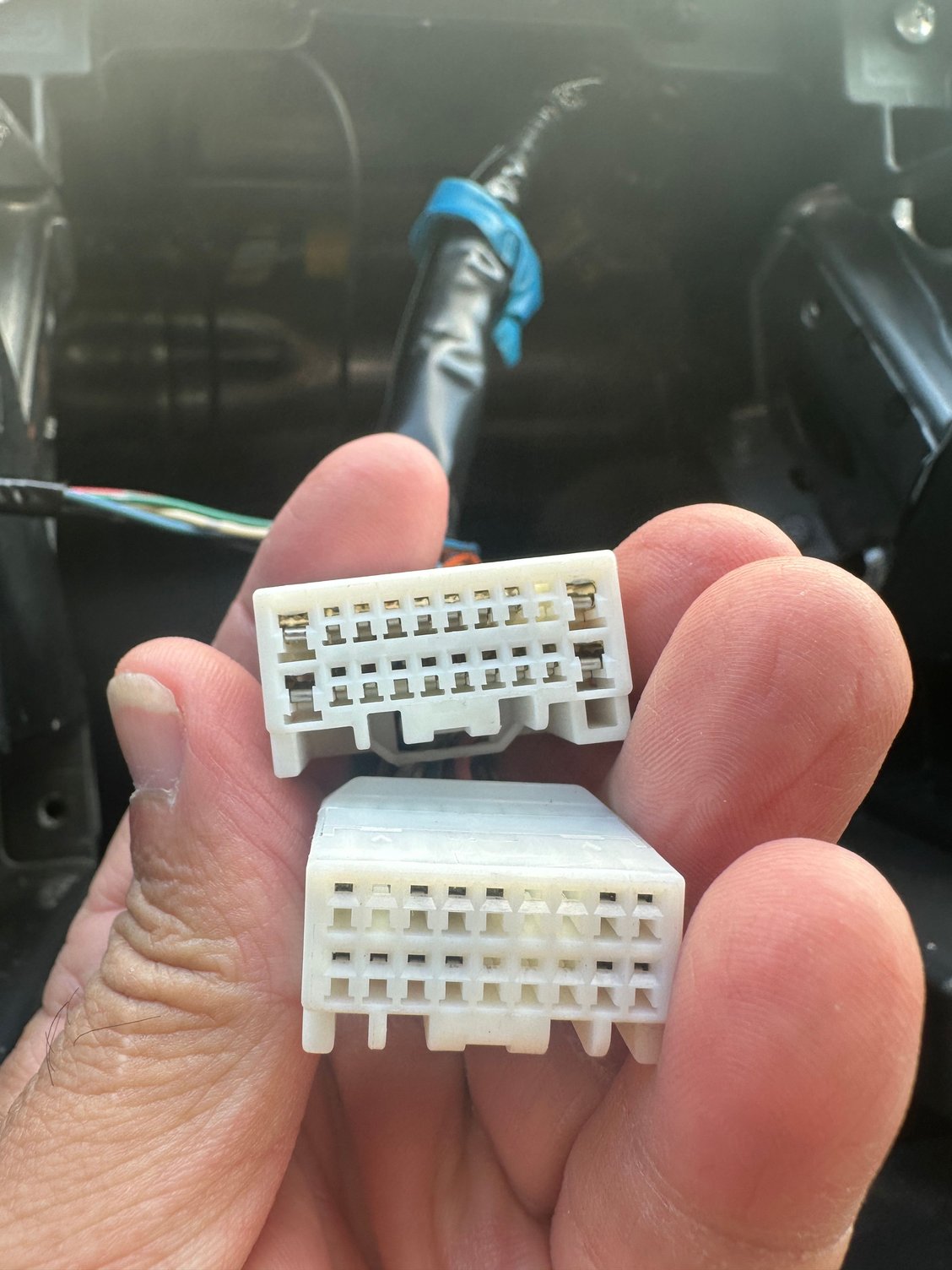

I bought an aftermarket radio. Unfortunately it won't snap back into the dashboard. It even stated that it would work before I bought it on eBay.
But I will say these 2 white box shape plugs both fit and work fine.
Just wondering what they do?
Here's the ebay post
https://www.ebay.com/itm/388485388038
Also, the image of both the dashboard radio bezel. The one with the wires is the aftermarket radio. As you can see both bezels are different.

When I bought a replacement Android radio for my Evo IX it came with an adapter harness to connect it to the car harness. Ask the vendor about why it's missing for you.
