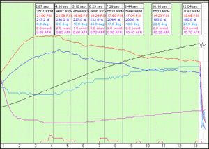

Here is a stock log running the 015 rom id, the richest one. The ZT2 does not go lower than 9.6:1. The LM-1 does not work with Evoscan 2.4+ and Hamish does not want to fix it.
my LC-1 works fine.....
LM-1 and LC-1 are different even though they are made by the same company.
