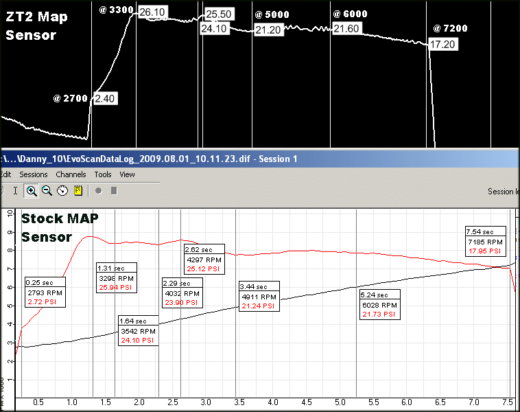

I posted this in the Logging thread on Aug 1 2009:
On Sunday I logged mode23 boost and the ZT2 boost with the medical grade Kavlico 3.5 bar MAP sensor I could not log the rpm with the ZT2 since the wire is not connected. I ran Evoscan and the ZT2 logger at the same time and logged the boost for the same 4th gear run. I compared the peaks and valleys of both boost curves and can confirm an almost exact overlap between the two.
I have compared the JDM MAP sensor to the GM 3-bar MAP sensor on my Evo 9 and they were very close.
Good to know that mode 23 boost is accurate
I am at sea level and the formula is set to 14.7 barometric pressure.
