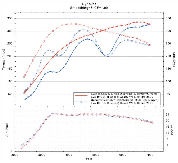

It has nothing to do with how many items I am logging. I am only logging TPS, boost, fuel load, boost, and rearO2AFR, on both Evoscan and OpenPort logs. I get 92 data points for both OpenPort and Evoscan in my logs, logging the same items on a 3rd gear pull. Time delta is approximately 8 seconds for the log on both. At each point in both logs I am at the same approxiate RPM for each time stamp. For some reason VDR doesn't like the format of the time and pukes. I can overlay my seconds column from Evoscan log over the time column in OpenPort log and it looks perfect (keeping in mind when they are superimposed on each other in Excel they damn near match perfectly with respect to time, value, and position.
With those 5 data points selected I get within .5 seconds alignment on data points between my standalone and Evoscan logs. I was apprehensive about it due to so many saying it got exponentially slower when using the standalone.
Update: Very odd, all of the logs are showing up fine this morning. Same logs direct from my OpenPort. I messed with them for over an hour yesterday and they all looked terrible and today they look like they should. Oh well, I guess it was a bug with VDR.
Update to Update: It stopped working again after reopening so there must be something wonky with VDR.

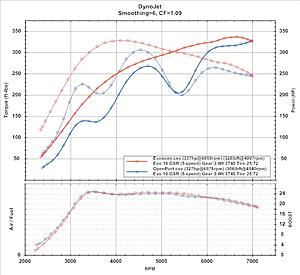

I took a snap shot of both 3rd gear logs and also loaded both in VDR so everyone can see I am getting roughly the same data points for both logs. I really hope I am just overlooking something obvious. I will post this over on the VDR thread as well, maybe it is just a VDR thing. Something is going wrong with the calculations. If you look at the boost curve the points damn near line up perfectly.
Attached Thumbnails Logging with the (Beta) Standalone Tactrix Cable Logger (No More Computer!)-openport-vs-evoscan.jpg
