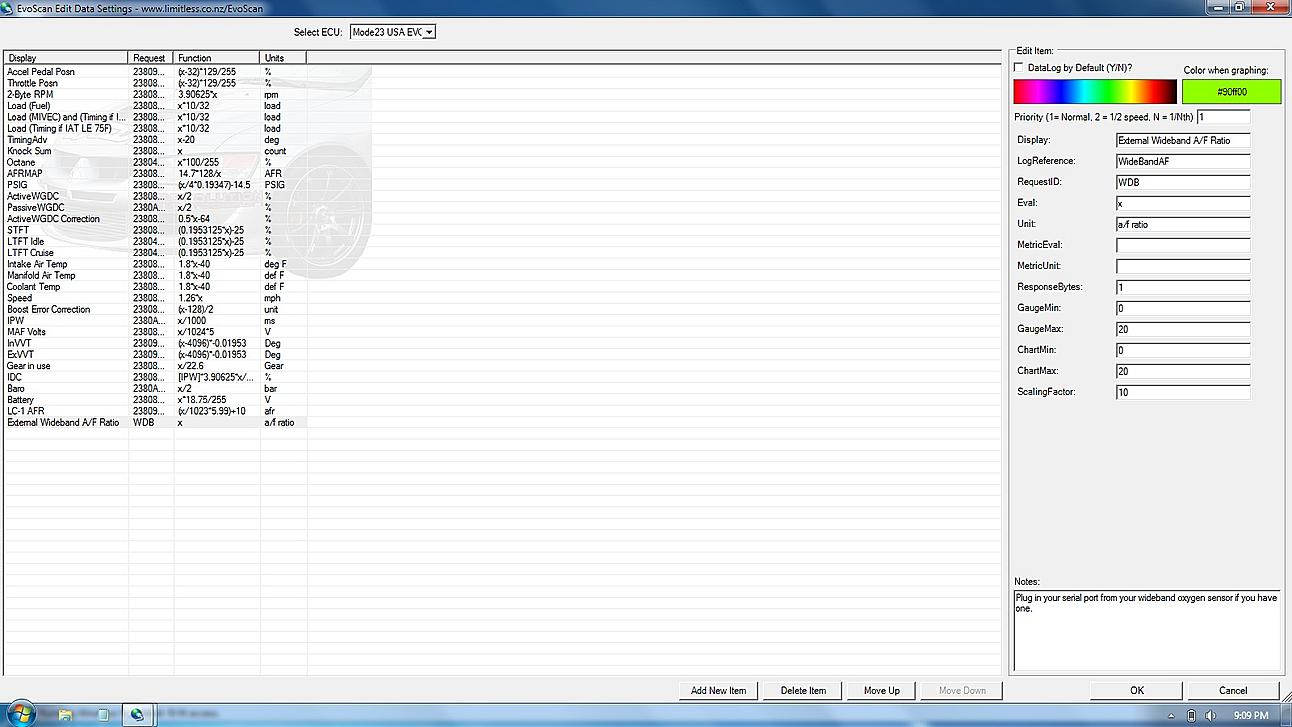

evoscan settings for wband

It looks like a few things are different with ours. I also should have made note that I drive an VIII not an X.
It's up to you, but perhaps you can change the two values we have different and see what happens. Make sure to write down the settings as they are first.
