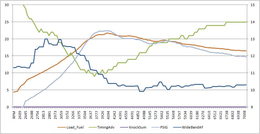

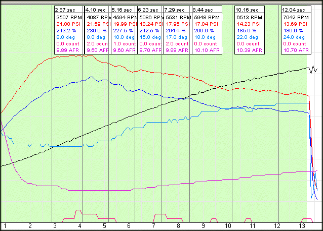

Here you find the 2 logs I was talking about: they are REALLY very similar, I have them here in Excel and pratically you can overlap the 2 graphs, but I ensure you that one is with ROM 52680018 and one with 52680022 (sorry, here I had to stop at 7k rpm because of an idiot in front of me).
My only mods are HKS Hi-Power CBE and Ralliart panel filter; ambient conditions were 98.5 kPa (14.3 psi) and 28°C (83°F).
52680018
52680022
LaXGSR, we can compare them also to your stock log of ROM 52680018
and Tephra's log with stock ROM (which one? Maybe AUDM?)
and finally nj1266's log of ROM 52680015

Thanks for sharing your logs! Those are really helpful and look identical to me
