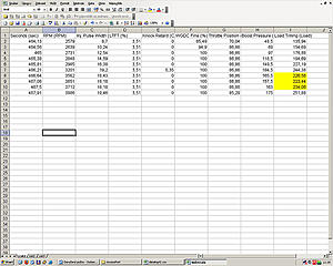

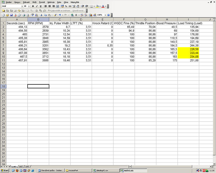

Hi,
I am running Cobb Stage2 93 maps, can you please advice me how to tune out the gap in Load in 3-4k RPM? in 4000 - 4500 RPM the load jumps up and goes slowly down by redline. This is 4th gear pull.
Both selenoids are maxxed out already.

The load will always go down toward redline. (Not sure if that was part of your question)
Regarding the cells you have highlighted, are you going over your boost target load?

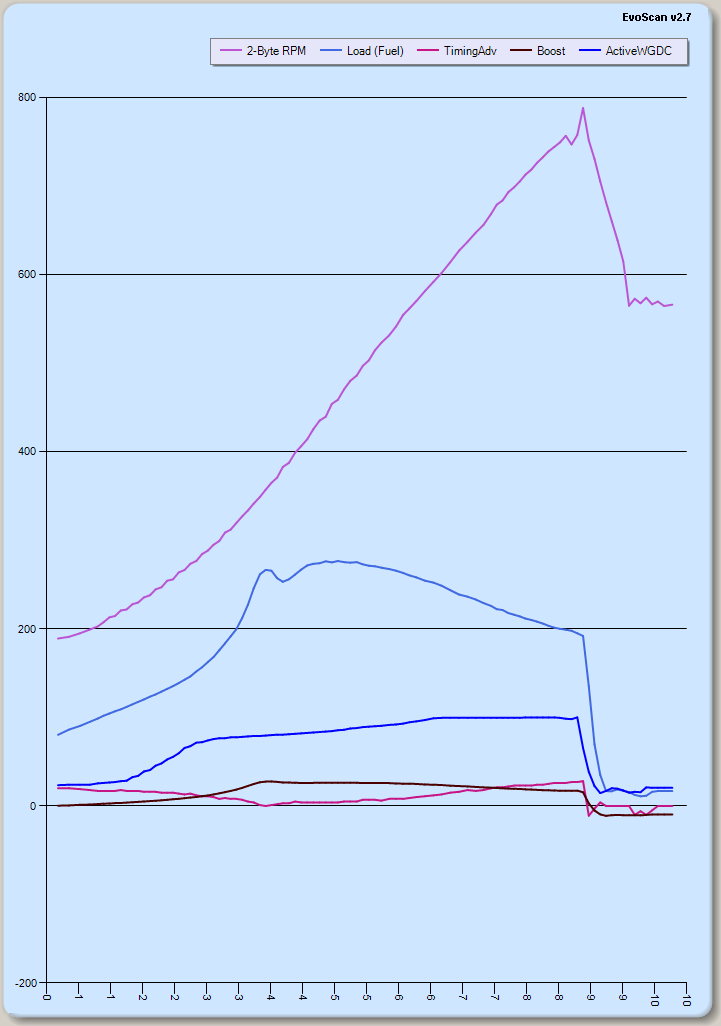

c- despite (b), your spool characteristics seem fine. however, you are at 100% WGDC beyond 2750, whereas I am at 71%. You are on stock boost solenoids? I am on a GM BCS. Logging Active WGDC Correction, as well as Boost Error Correction (if it works for you) would be helpful (as would a longer log).
Attached you will find an image and log(rename to .csv) of a 3rd gear pull I did this morning that illustrates the [b]load/[b] dip you speak of(note, no dip in boost). Because boost remains a well-formed curve, I am confident I will be able to smooth this out with a little bit more WGDC in that area and a degree or two more of timing.
(did I mention I love map tracer? wish the x/y axis were user-definable so you could tracer other tables besides timing/fuel)

Well I am not hitting my Target Load, so there should not be any correction kicking in.
I run on Milltech TB with HFC, stock boost control - both selenoids are at 100% in these conditions.
How could be Mivec tweaked to help with the dip?
