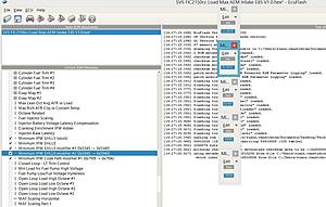

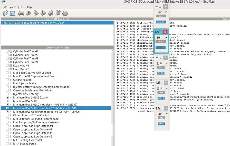

Chet,
Thanks for the info.
I've tested that code and it wont let me do what I want. I'm not sure if it's the user or code.
If I adjust the 'new' minimum ipw (IPW SHLL0), it adjusts the "Old" IPW at the same time (they are linked) and I end up at about 36ms minimum pulse width (logged in evoscan).
Below are the settings that appear in ecuflash (screen grab) and also the xml file with the code inserted.
With the minimum ipw set at 1..024 the car will idle comfortably if started and it remains stationary, however, if driving and on decel (ie slowing down to a stop at lights) it bounces everywhere and will vary between very lean and very rich rich and stall.
If I increase it, it runs pig rich. I'm pretty sure the patch didn't work as intended. Can you please have a look at the xml for me?
