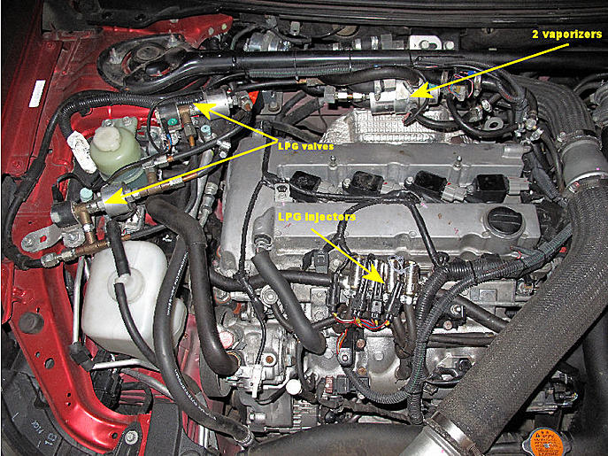

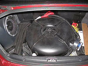

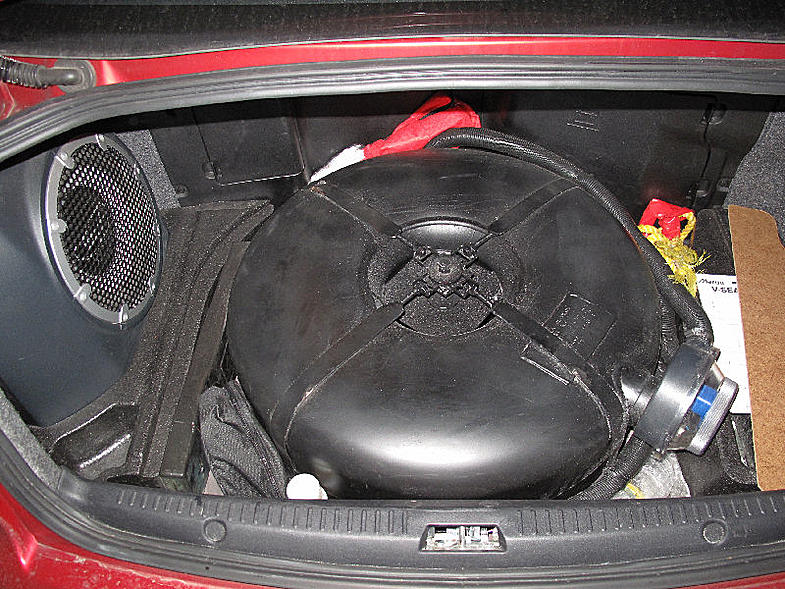

Hereby I post some pictures of the LPG injection system and the fuel tank in trunk.
Attached Thumbnails Cold start problem - MR-img_3084.jpg   Cold start problem - MR-img_3085.jpg
