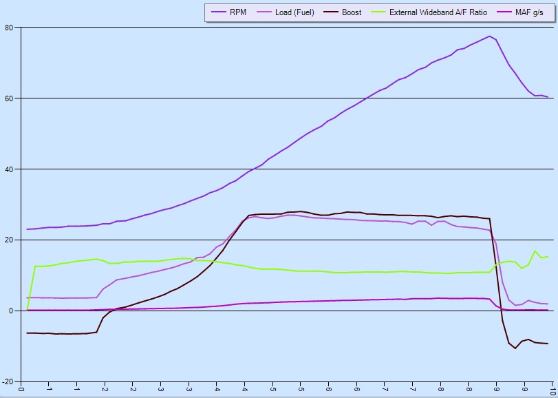

Has anyone else seen fluctuations like this before at high rpm?:
We thought it might be the K&N dropin I have, so I switched to an open cone filter with no change in issue.
Does this look like high rpm BOV flutter?
BTW, in the graph MAF= maf grams/sec

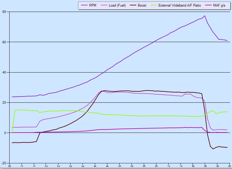

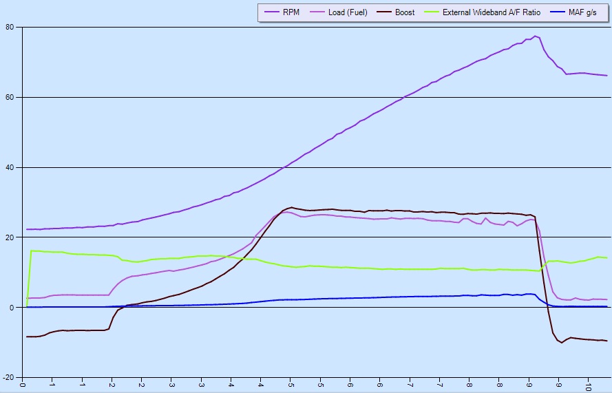

I cleaned the MAf with some high quality electronics cleaning spray. This however, did not resolve the issue.
Run1
Run 2
Run 3

Oh, definitely not the MAF spiking.
Though, your load does seem really low for your modifications. Have you logged MAF voltage?

Yep...hit 4.85 at redline.
Is your load graph scaled really funny? Cause 240-ish load is a little low for that kind of airflow and boost. I'm thinking more like it spikes to 285 or so and tapers to 265. That would make more sense.
But otherwise, I think everything looks good on your end. I would worry if you start to get IDC spikes. That's the indicator or something being horribly wrong.

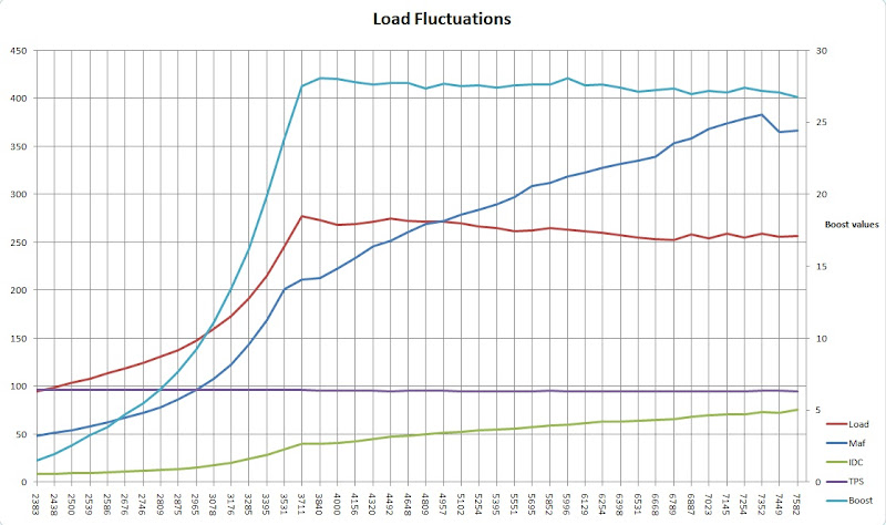

Load peaks about 280-290 and tapers to 240-250.
I do get IDC fluctuations consistent with the fluctuations I am seeing in load. The car drives fine and accelerates smoothly, there is no feeling that something weird is happening. The only reason I even started a thread on this is because i also get some slight knock in this area that is proving difficult to resolve. I believe the fluctuations may be causing the knock.

It looks like it stays pretty in-line with the boost... Personally I wouldn't be too worried.

Is your ignition timing advance bouncing around due to the load fluctuations? This can induce knock possibly.
Nope, timing is stable.
I really can't find a root cause.
