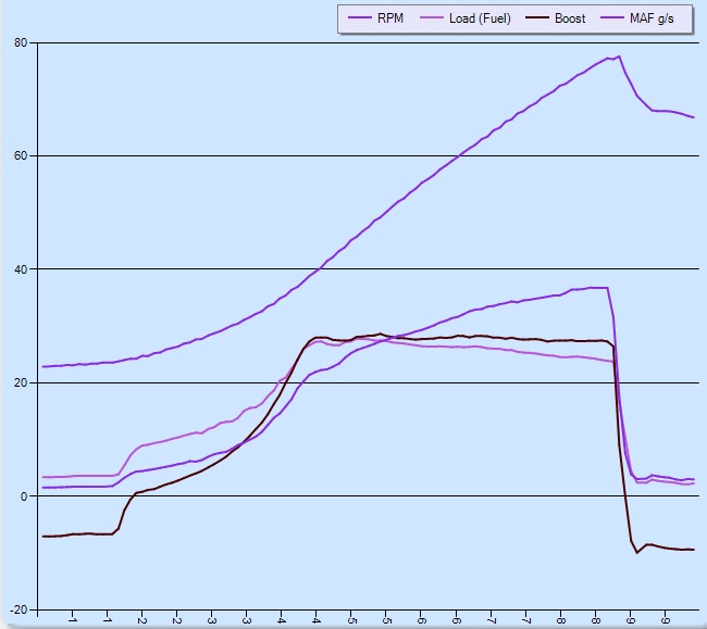

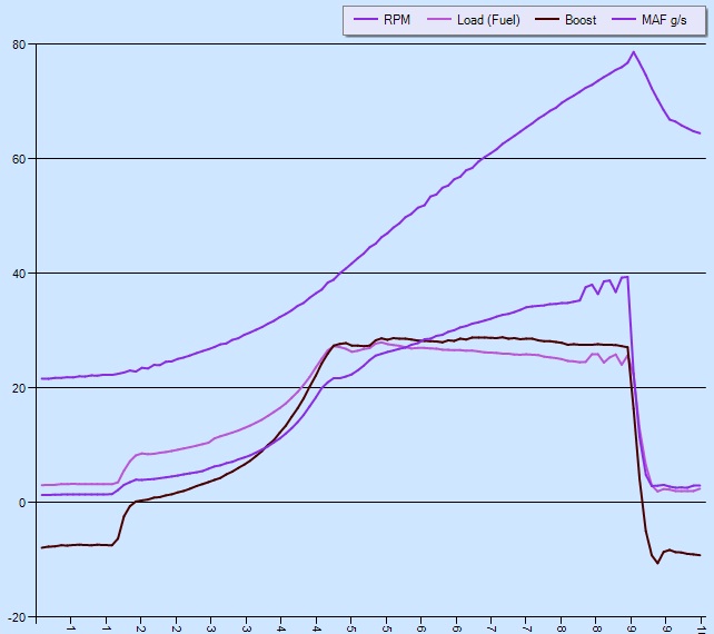

Update : SOLVED!
First off, thanks to Jon of Cobb for steering me in the right direction, he was spot on with his analysis.
I tried testing the BOV, cleaning the MAF, different air filters, installing a UICP and nothing seemed to get rid of the fluctuations.
Adjusting the "MAP" tables to more closely match actual load seems to have solved the issue. If not solved it.... it has masked it.
Here are two logs, both on the same day taken hours apart.
Before adjusting the MAP table:
After adjusting the MAP table:

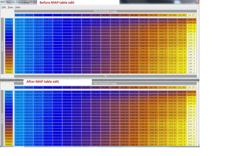

Old Oct 25, 2010 | 12:34 PM
tsitalon1's Avatar
Posts: 2,072
From: Southeast USA
Sure thing guys. Love to share
Disclaimer: This worked for my car..might not work for yours. Hell it may blow your car up. Use at your own risk
I only changed the last column on the right from 5k-8k to match my actual load.

Interesting! So its probably just following this instead of jumping between it and one of the other 2 values that tephra pointed out in his thread.
