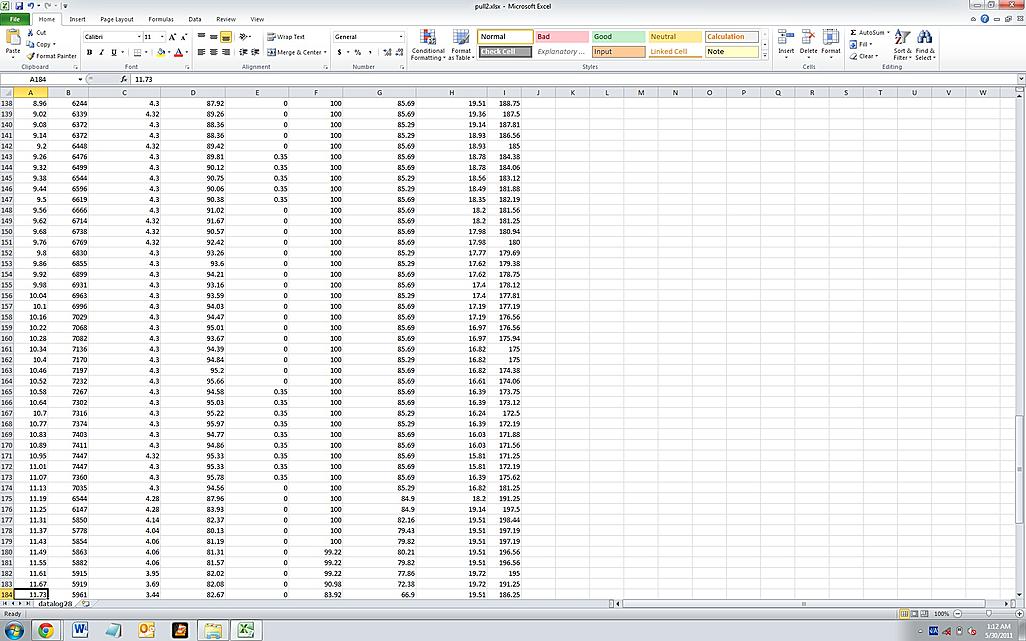

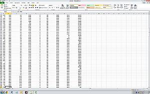

Take a look at this map for me. I have a HFC and cbe. I'm running stage 2. It says im over boosting, but i'm not getting any CEL, my fuel trim is under 8% and i'm not getting any knock. It says im at 28psi, i switched to lwg maps and it says im getting only 20psi then. my boost pill is out, i plan to put it back in and see what happens, my question is, if i'm not getting any CEL or spikes, it just seems like it spools up correctly and linearly, and its within fuel, no traction control issues, i live in PA, is this a problem?

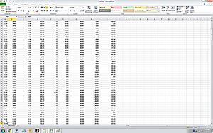

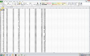

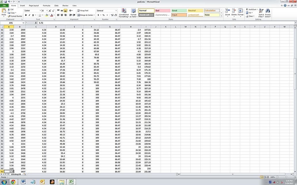

pull 1
Attached Thumbnails stage 2 over boost question-pull1p1.jpg   stage 2 over boost question-pull1p2.jpg   stage 2 over boost question-pull1p3.jpg

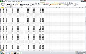

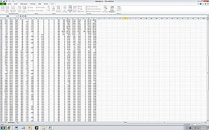

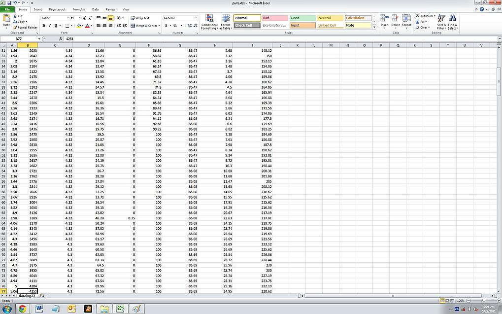

pull 2
Attached Thumbnails stage 2 over boost question-pull2p1.jpg   stage 2 over boost question-pull2pt2.jpg   stage 2 over boost question-pull2pt3.jpg

Columns in order L to R; time, rpm, acceleration pedal pos, inj duty cycle, knock, wgdc fine, throttle, boost pressure, load boost/fuel
