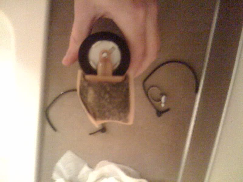

I tried to type this earlier from my phone but it kept screwing up.
Here is what the stock evo X fuel sock looks like on E85 after 6 months.
Also just an FYI, the thing pictured is not a filter but it does break down in E85 as you can see. That is simply the fuel pickup sock. The actual X filter is contained in the stock fuel pump so if you put a 255 in the system you have removed the fuel filter. This is why the blaqops kit comes with the jegs filter to put inline in the engine bay. Also blaqops does use the 8/9 sock on their kits too.
just some food for thought. If you use a 255 get an aftermarket E85 safe fuel filter for your system. A side note I did run my X without a filter for months but I wouldn't recommend it.

That doesnt look very healthy....lol but this is good to no!! Correct me if im wrong but has blaqops quit making there double pumper? Cause thats the company i origanlly wanted to go with....Or does the Bushur do the same thing with replacing a new filter for you???

I'm sure that black foam around your pump wasn't so E85 safe either. haha. That might be what's in your fuel sock too.
Totally possible. It looked alright when I pulled it out though. I just did a DIY type 255 holder because at the time the only one out was the 300 dollar holder from UR.
The kit worked great for the 6 months I used it
