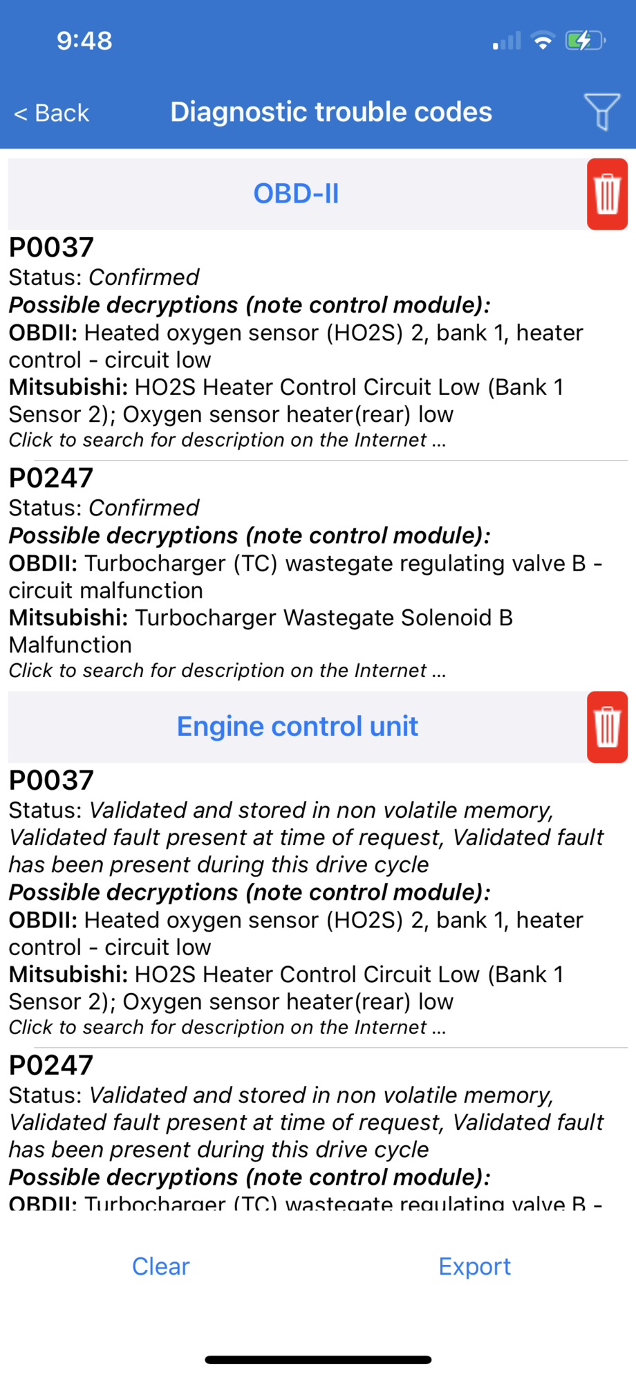

I have this wastegate code on my 2015 Lancer RA. The code came up right after I got a tune and I don’t know how to get rid of it. I have a Cobb EBCS if that helps. If any of you know how to get rid of this code or have had a similar issue in the past please lmk!

Hey, dont know if you solved your issue yet or not but first and foremost double check that the ebcs lines are installed and routed properly. Also i believe the newer lancer/evo stuff had two solenoids and the one needs to be left plugged into the vehicle. Check that the correct one was replaced by the ebcs you are using and that the other one is still instlled and plugged in. Another thing to check, and you might need to confirm this with the ebcs manufacturer instructions but some ebcs solenoids either require keeping ot removing the boost restriction pill. Things to check,, post up if you find a solution, best of luck..

Ralliarts have a single solenoid so they are different from the dual solenoid system that the Evo X has.
The code issues above are from the tune. I advise these people to discuss with their tuner as their tuner forgot something.
