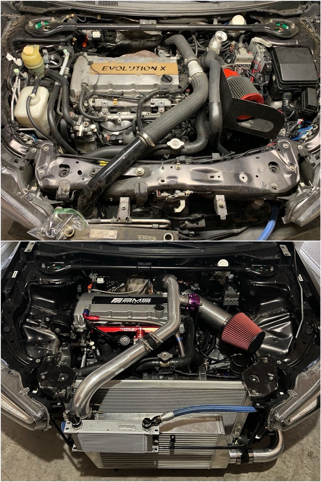

Bought this car blown, built it and did a front half rewire and wire/ fuse box tuck and installed standalone in the car. Car ran after rebuild with the oem ecu and wiring but I can't for the life of me get it to pull out of the driveway without dying now. Yes wiring is square, the timing is right top to bottom, scope looks like it should, everything is scaled, dwell times are right, and all inputs and outputs are giving/ receiving appropriate signals. Something is off in the timing or VE tables. I'm willing to pay someone to go over my logs and make adjustments to get it rolling down the road. Don't need a full tune, I'll take care of that myself. Car is sleeved, MIVEC delete, ethanol, big pumps and injectors, big cams yada yada yada. Any suggestions? Thanks in advance.
