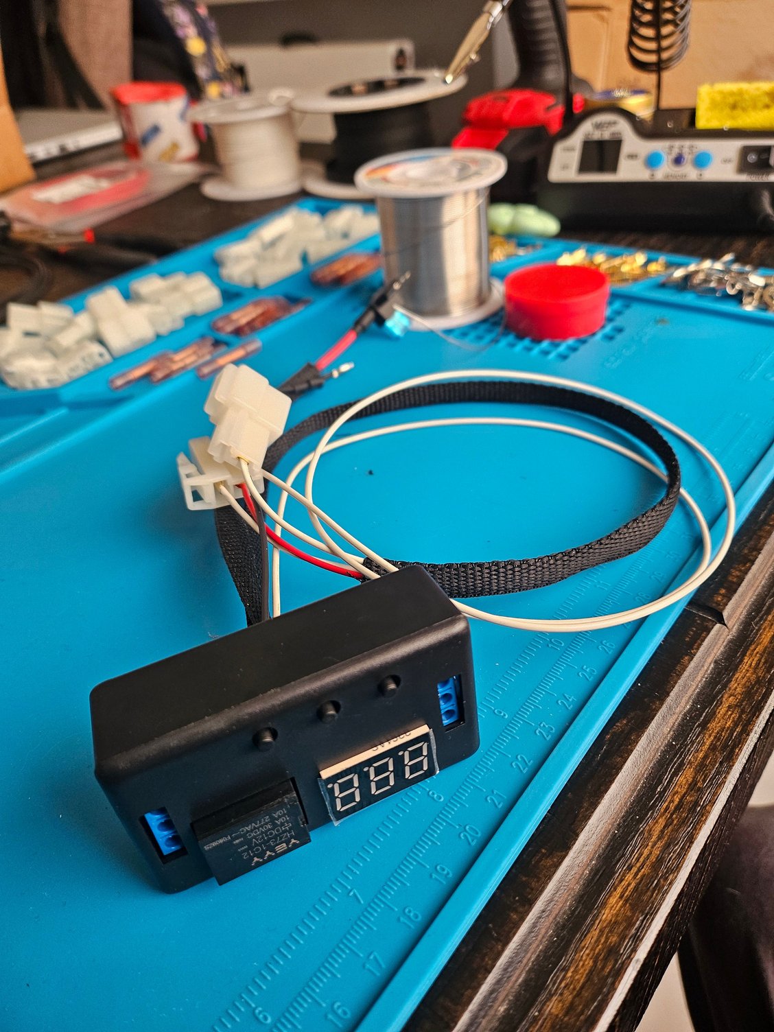

about a year ago, i set out to see if it was possible to have a sort of rolling antilag feature on the stock ECU because i had a GTX3576, pretty laggy and was not wanting to keep beating up my brakes with brake boosting. i downloaded electrical diagrams, wiring diagrams, tried different things with different maps and finally was able to get it kinda working! after about 6 months of what ever free time i had from my day job, i went from my experimental harness to a full plug in harness with oem connectors and a refined tune so everything works in harmony.

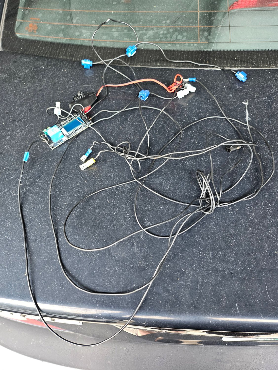

How it started
How it started

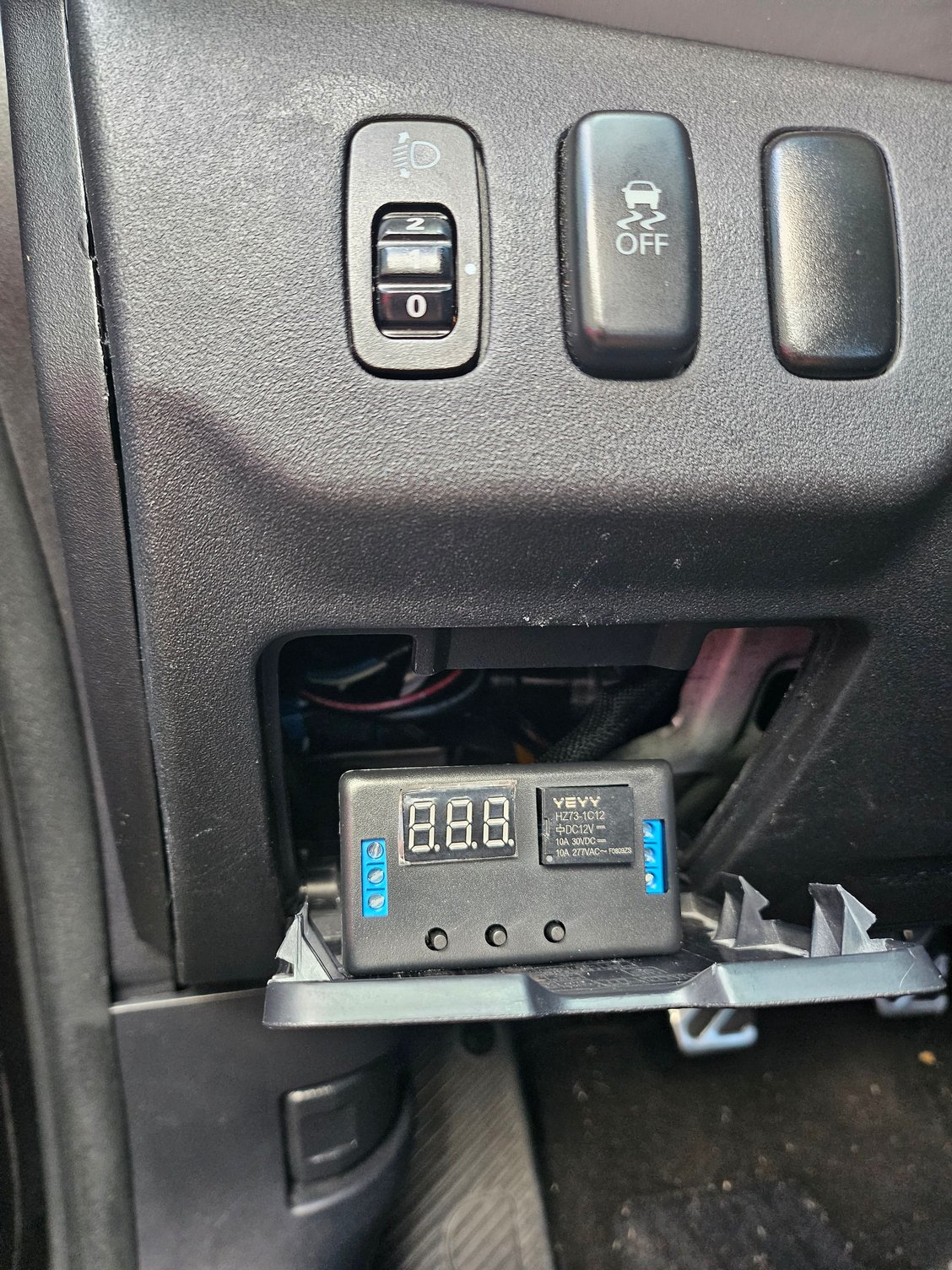

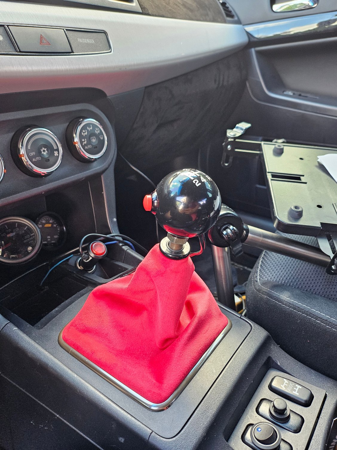

My button of choice for now
