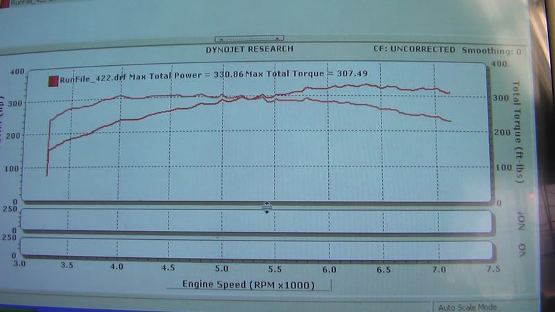

Today we tested a Forge WGA upgrade on a Evo X with just a cat back exhuast which previously made a best of 319 whp on our dyno
We installed the Forge upgraded actuator and found that the boost held significantly better through the power band
Power increased to 330 whp with a very conservative tune, but peak numbers dont tell the whole story as the shape of the curve is much improved and the power climbs all the way out to the red line

11 peak whp sounds about right going from a stock WGA to the Forge. Once you preload the stock WGA that peak number becomes very similar as the turbo is doing all it can at 6k and above. Now at the 3-6k range I've held very steady boost in the low to mid range RPM's and the car has gained a ton of torque and better hp under the curve.
I set my boost in 5th gear for 26 psi and it will hold 25 psi in third all the way to 6k after which it tapers due to flow limits. The stock WGA would allow taper at a much lower RPM unless you really over preloaded it to the point of not being able to run lower boost due to restricting the internal wastegate flapper. The Forge WGA is a great upgrade for consistant and controllable boost levels and I can recommend it even if the stock turbo prevents it from improving the 6k+ rpm range. I would also be interested to see an overlayed dyno sheet of how mid range is the biggest boost with this mod.

Interestingly, on this car we were unable to set it to achieve lower than a 25 psi minimum boost spike on pre load. We were running the boost through a Forge UNOS MBC. On pre load we set it with the least amount of pre load we felt prudent so that there were sufficient threads in the fitting at the end of the rod and the minimum boost spike was no lower than 25 psi. We tried 2 full turns extra pre load and it had no effect on the boost level or power.
The car seemed to hold 22 psi or 21 psi of boost for a really long time on the road. Frankly, while the peak power increase was not that earth shattering, the change in the feel of the power band was very inpressive.
Bang for the buck wise its a great modficiation.

Here is the dyno sheet
