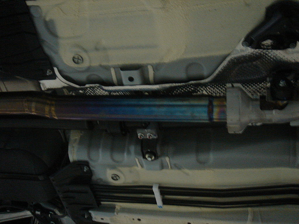

i just came accross the following attached picture. is this what you're talking about? can i just cut that whole flared piece off?
