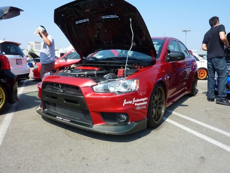

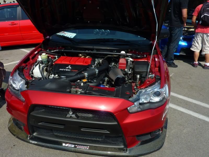

Gt35 on my x
Old Aug 17, 2009 | 09:31 PM
evo_x_monkey's Avatar
Joined: Sep 2008
Posts: 7
From: claremont
Gt35 on my x
* Etxtreme Turbo Systems (ETS) 3 inch intercooler
* Clutch master twin disk
* ETS Intake system with K&N filter
* ETS Intercooler piping kit
* Ultimate racing 3 inch downpipe
* Ultimate racing 3 inch testpipe
* AMS single tip full 3 inch exhaust
* BC 272 CAMS
* AFI GT35R turbo KIT
* HKS SSQV Blowoff valve
* Methanol injection kit Aquamist
* Custom EcuTEK
* UR EVO X Fuel pump housing adapter
* UR hi flow fuel filter
* Walbro 255lph High output fuel pump
* AMS fuel rail
* RC 750cc Injectors
* AMS stud kit
I will post the dyno result after its tuned soon!

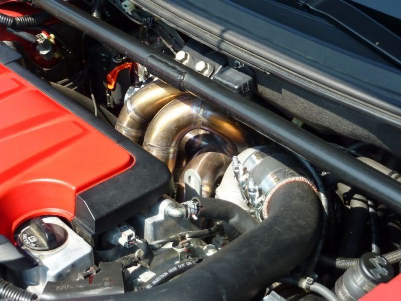

With open headers like that be sure to place a heat shield around that connector on the back drivers side corner of the engine, or at least some DEI cool tape or something. I had the upper portion of that plug start to go molten on me after some "test" runs even with header wrap.
