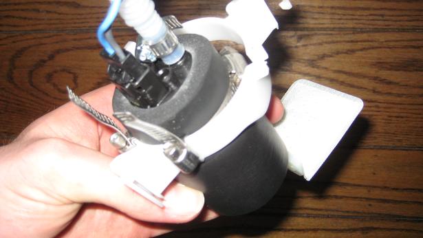

My Walbro Experience
I did the foam sock procedure that was written by meat_evo. It went really well and the pump is very secure with stainless steel hose clamps. Also, there's no noise coming from the pump, I guess that foam helps out with noisy Walbros
You'll need a 8mm socket on a 1/4" ratchet to fit in the tight spot.
If you are using a 4in1 screwdriver, take out the bit, your 5/16" driver will fit on those 8mm nuts.
My low fuel warning light was on and I let the car sit for 12 hours. When I opened the fuel lines nothing squirted out, just a drizzle when I moved the fuel line off to the side of the pump.
I didn't disconnect the battery and I'm still alive
I did this by myself in my apartment bathtub. My car is 2 blocks away. The hardware store is 5 blocks away. I made 3 trips to the car and 2 trips to the hardware store and I was done in 3 hours.
I'm not OK with using zip ties, so I opted for stainless hose clamps. I used the housing clip for support and it looked good and held tight. I'm including some pictures so you can see what I did.
I couldn't have done this without the "How-To". Thanks to meat_evo!
I installed the Walbro GSS317 pump. Many of you have chosen the GSS342, but my tuner [WORKS Motorsports] recomended the low pressure pump for applications under 500hp. They said the 342 can overpressure the fuel pressure regulator at idle and partial throttle causing SMOG problems and a confused ECU.
I bought the pump from WORKSEVO .com [came with the exact fuel filter that the "How-To" mentioned, and got all the bits from apeusa.com. If you are going to buy from WORKS, then don't bother buying a filter from apeusa.com, it's the same exact filter. Now I have two.
I also went to the hardware store and purchased three stainless steel hose clamps
1: 1-5/16" to 2-1/4"
2: 5/16" to 7/8"
Total: $4.25
I made another trip to get some Dap Blue Stik Reusable Adhesive Putty because some of the black gum was destroyed when taking off the cover.
Adhesive Putty: $3.28
Here's another tip. After you take the housing out, crack the windows and put the cover back on or put some box tape or duct tape over the opening so that the gas fumes don't infect your interior. I used masking tape because it's all I had laying around and left the car for 2 hours while I was working on the housing and the interior doesn't smell like gas.
Car is running good and about to be screaming with some Cosworth cams.
