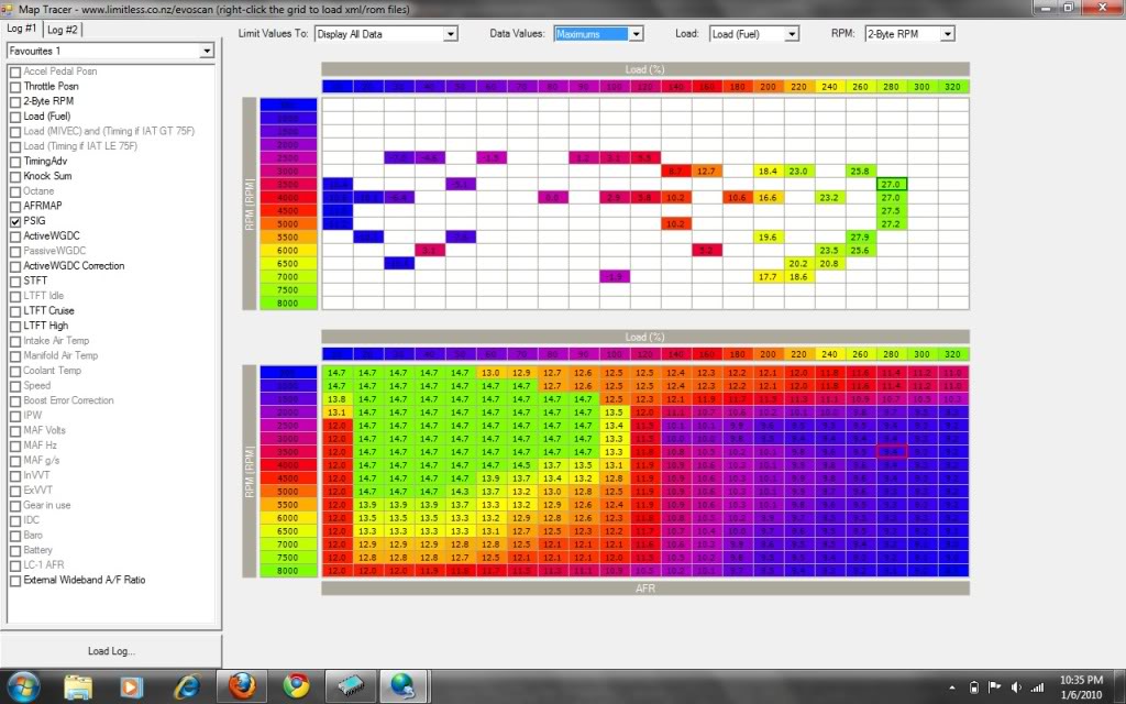

Here is a 3rd gear pull... Holds 27 psi easily...
Probably enough for most people. My conclusion is if you want your BOV to hold a bit more you can try this mod. Does not affect driveability at all. Works like stock.
If any one tries this out post your results.

I have a question. I agree that the boost reference port on the bottom of the valve will make it more responsive, since at light throttle, the pressure inside the pipes will actually push the valve open. You say that's it's holding 27psi just fine....how do you know for sure?
There's no way to really know unless you do a dyno run with the hood open and actually watch the BOV to see if it gets pushed open at full boost. Even with a leaking BOV, the turbo can still maintain boost pressure, it just works harder and pushes hotter air. That's the only problem with having a BOV with a boost reference on the bottom of the valve. They can easily leak.
