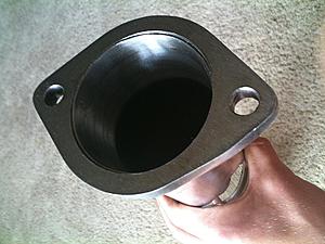

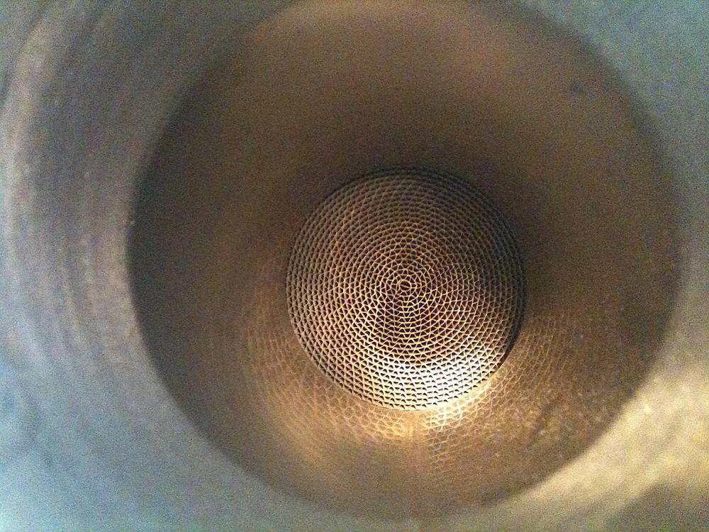

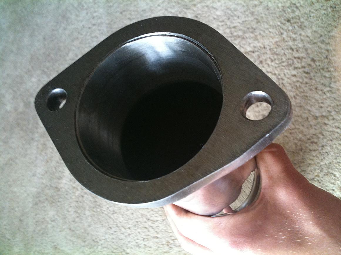

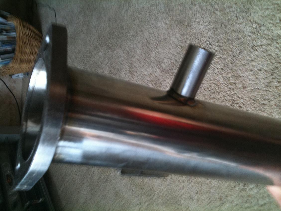

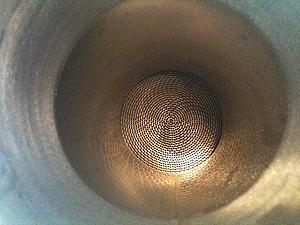

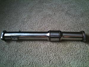

Heres a few pix of the depo racing 200 cell HFC
unfortunately i'm still waiting from the cat back from ETS, Michael informed me yesterday that it would probably be finished today
Being patient
Attached Thumbnails Hi flow/Cat back install-image.jpeg   Hi flow/Cat back install-image-1-.jpeg   Hi flow/Cat back install-image-2-.jpeg   Hi flow/Cat back install-image-3-.jpeg

The O2 sensor goes behind the cat on the HFC correct? not the other way around?
Correct
