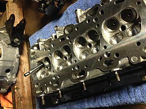

I do all my own work, you pay other people to do it for you because you don't know how. Trust me even with stiff springs and high RPM you won't wear the seats down anytime soon. Seen plenty of heads with over 100k still look like new. So yes it's BS when you say it will be worn out in a few months. I grind my seats 5 angles then blend in the bowls. 30-45-55-65-75
