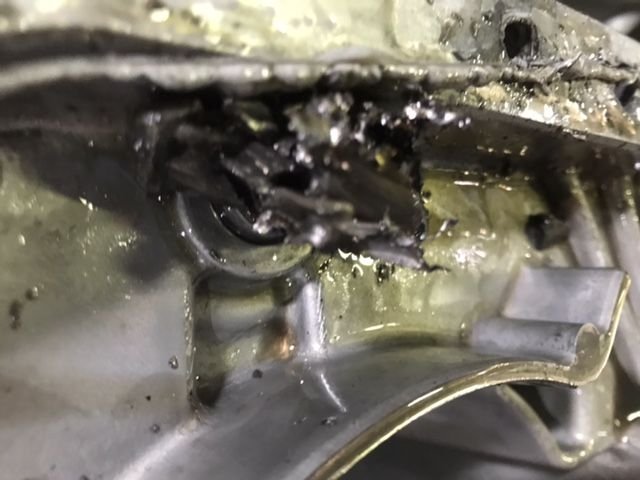

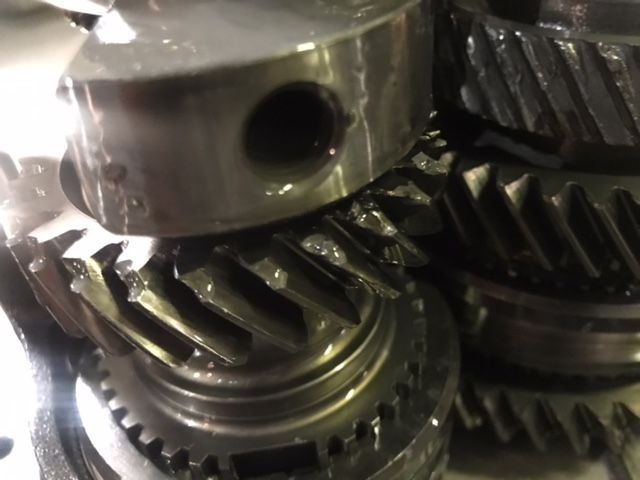

UPDATE:
Took the car to JMS Racing in San Antonio. They confirmed that it was not the clutch, So they cracked open the transmission. What they found was that from a horror story (pics). Needless to say Shep Transmission is doing a build for me. The woes of big power....
