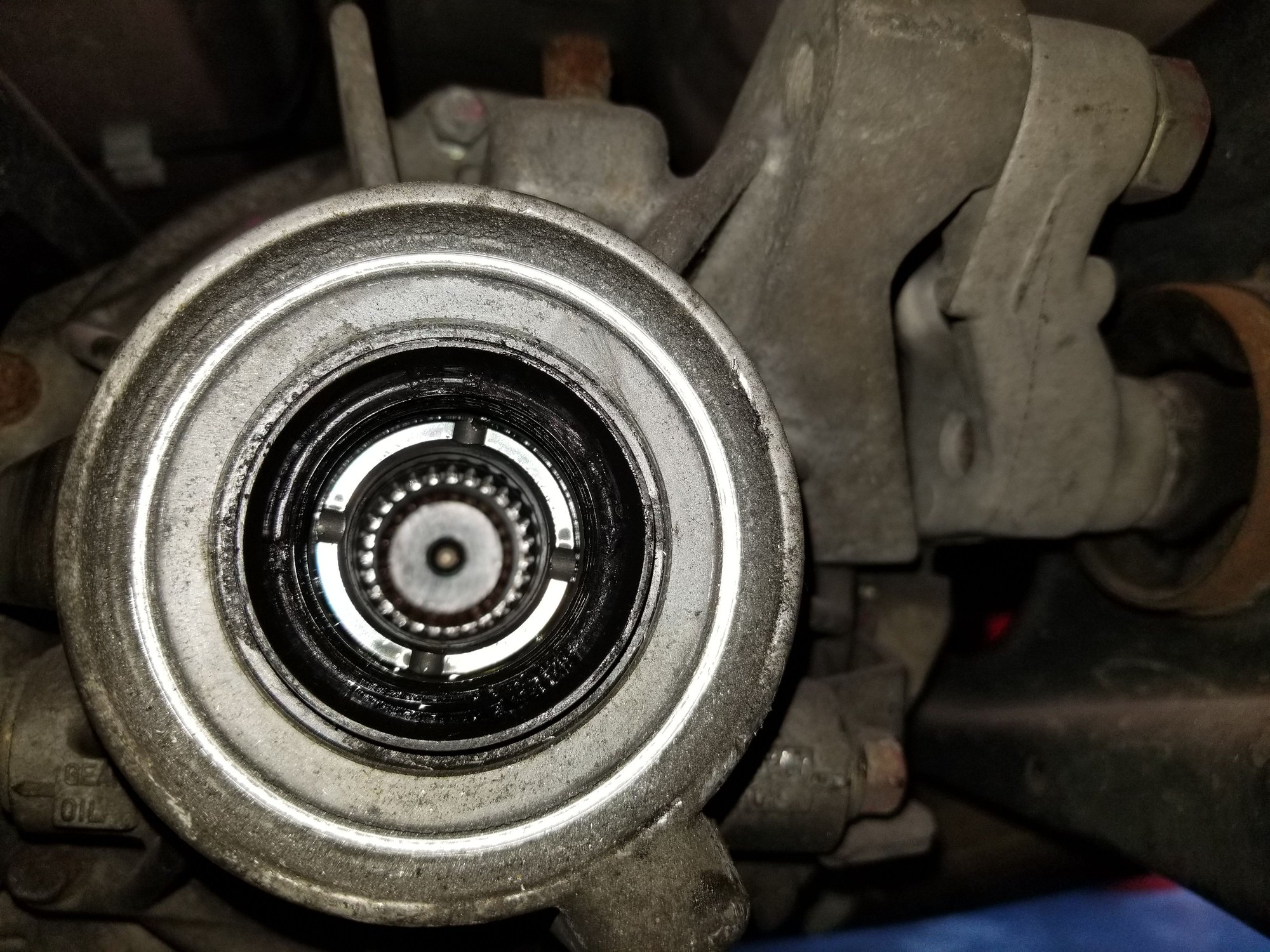

so I was cruising on Highway doing 80 mph and all of sudden my car started shaking massively.
Car seems fine when I am doing around 25 or 30 mph so I thought may be wheels are out of balance. I got wheel balance and alignment done right away but left rear wheel is still shaking.
Decided to put car on all the jack and saw left rear wheel wobbling along with Axle.
Close up left rear diff/ Axle socket

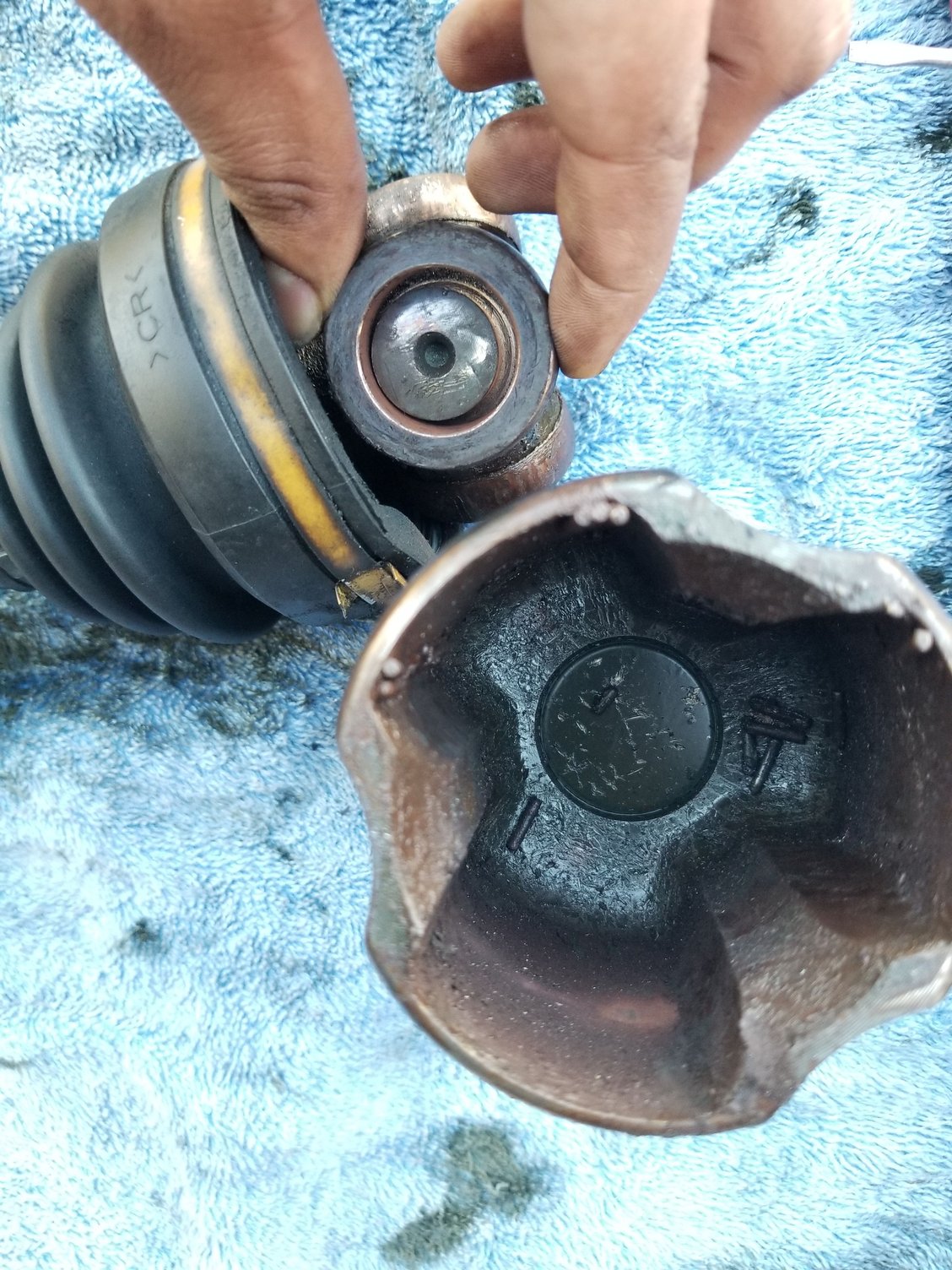

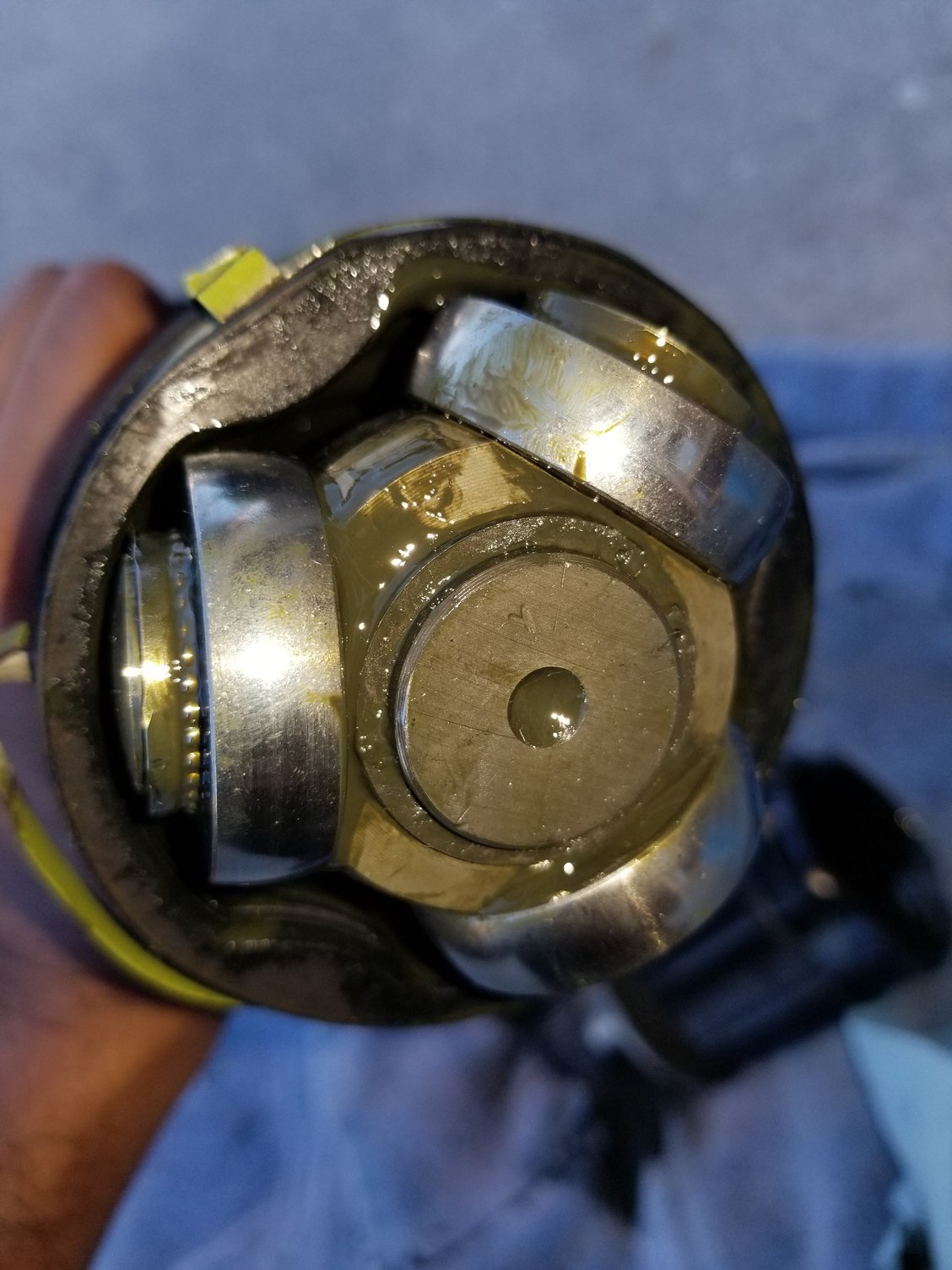

I've removed the rear axle and inspected Axle and Rear diff but not sure about what's the issue. Any pointer or help is greatly appreciated.

Update: Changed rear axle and rotate my tires too. However, rear driver side only wobbles when I am accelerating. Car seems fine the moment I take foot off the pedal.

Front Passenger Axle boot leaked and broke the inside of the axle. It was the side that connects to t-case which made it look like t-case was the issue. Changed the axle and everything is back to normal.
