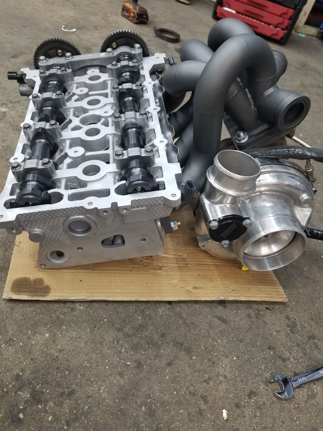

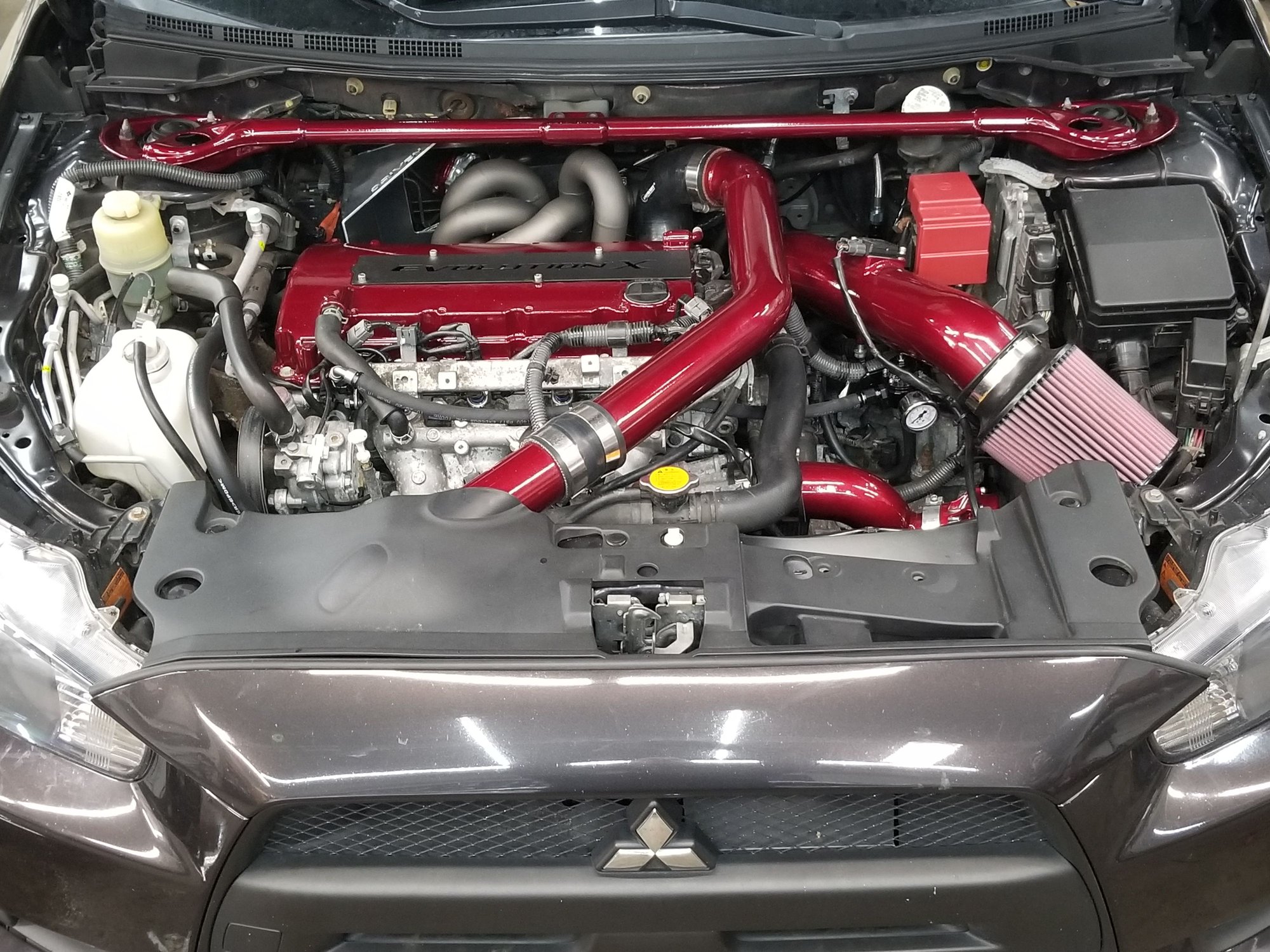

Hey what's going on on everyone. Im interested in finding out if anyone else is running a Full Race Twin Scroll T4 kit on their X. I just finished my build and was able to get it tuned. Car made 500whp/342tq at 26psi on the EFR-8374 running regular pump 93. The car is/ feels phenomenal and there was plenty of room to keep going but im still stock bottom end so didn't want to push it any more.
The problem I am running in to is the idling issue. When I cold start the car first time, it will idle just fine with no known issues. If I shut the car off and then start it right back up, it will not idle properly and keep dropping to about 6-800rpm and choke itself out and stall. My MAF is clean and has no issues but we swapped to a brand new one and problem still occurring. Im just trying to figure out what the problem could be causing the idling issue. Before the build the car was perfect 100% of the time with no idle issues.
I would like to be able to drive this car and enjoy it without keeping foot on gas at lights to keep it from stalling. Any help or suggestions would be greatly appreciated.
