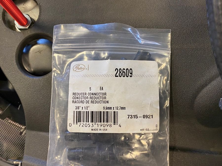

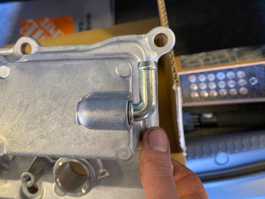

On the driver-side, the aluminum valve cover has a 3/8" (9.5mm) angled breather bung facing the firewall. It's different from the plastic cover's 1/2" (12.7mm) straight breather facing the coilover. My mechanic had to order aftermarket reducer connectors (p/n: 28609), and to use a couple of clamps and a 3/8" oil-resistant fuel/PCV line in store to make it work. (Mishimoto also makes a 3/8" catch can hose. The breather hose difference would be a nonproblem for AMS intakes, which comes with a 3/8" bung installed and an optional 1/2" bung included.)

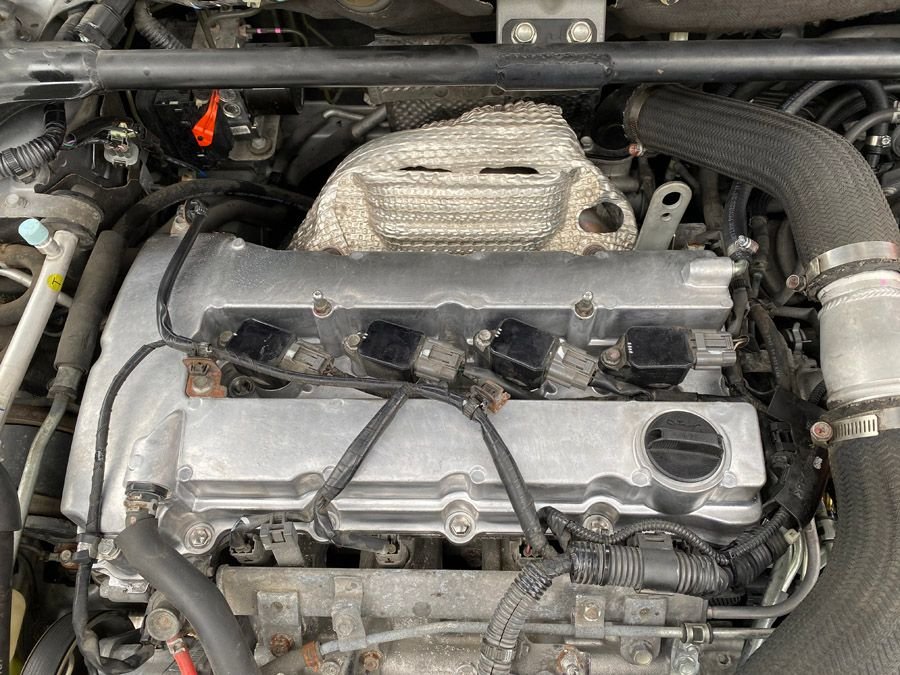

The wires have a lot of aluminum clips that cannot be simply moved from the plastic cover to the aluminum cover. Another Evo X owner Zijie He's guide "Up/downgrade to aluminum valve cover" helped. It took my mechanic more than an hour to fabricate and custom the clips.

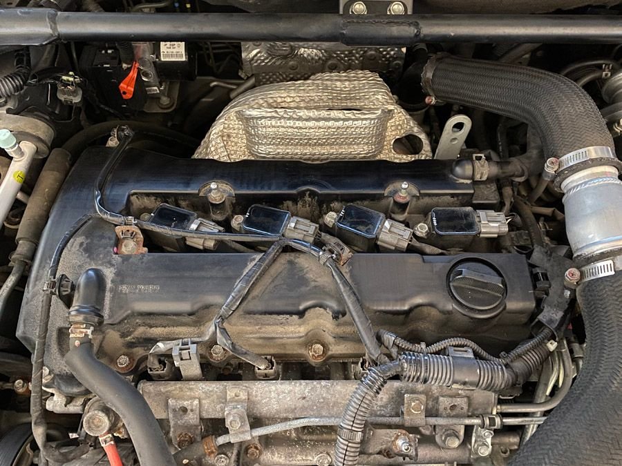

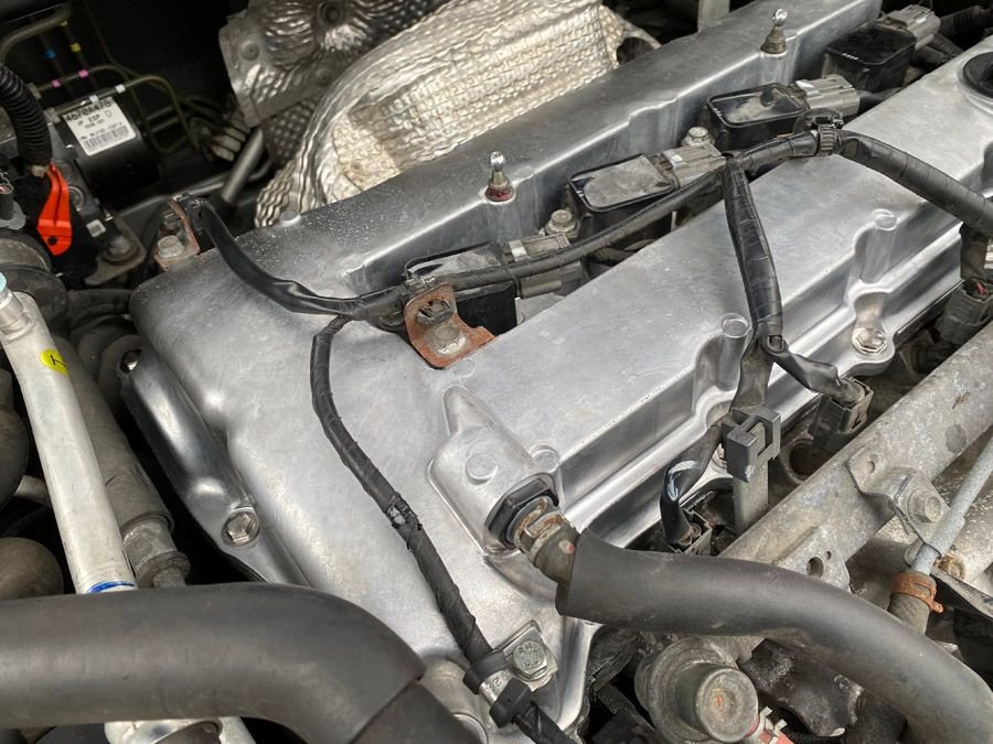

Old plastic valve cover. I used a Sharpie metallic silver marker to mark the ignition coils.

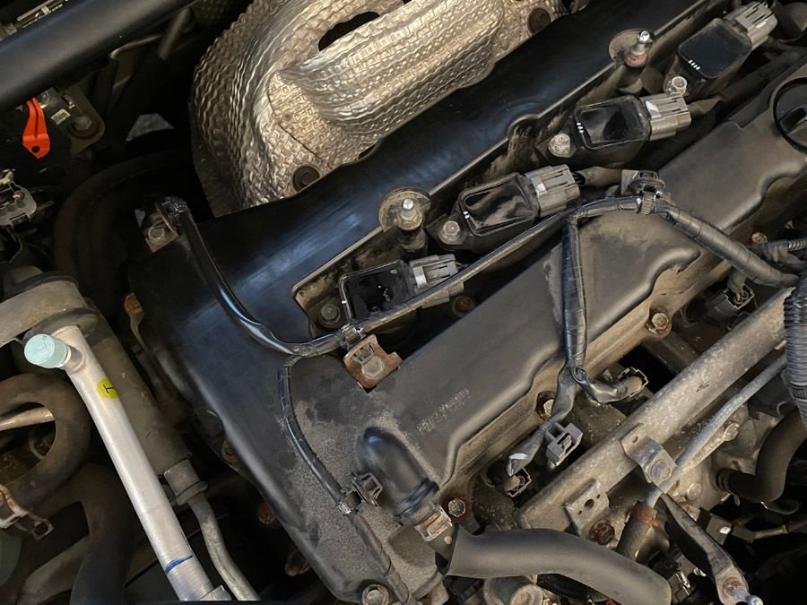

Wires sitting leisurely on the old valve cover without ever melting. It's Japanese sorcery.

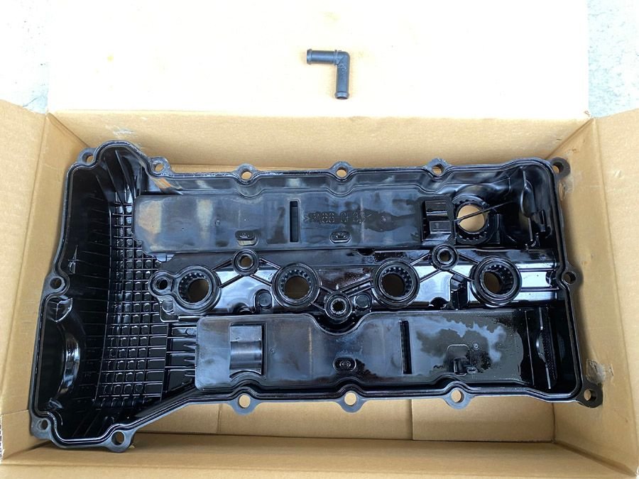

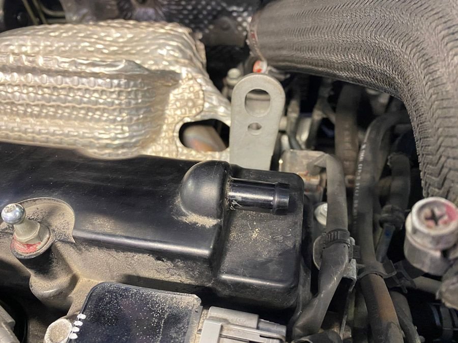

Plastic valve cover (1035A999)'s 1/2" (12.7mm) breather bung.
Aluminum valve cover (1035A810)'s 3/8" (9.5mm) breather bung.

Aluminum valve cover freshly installed. Some wire clips have to be fabricated.
After taking these photos, I proceeded to wipe clean the new valve cover. I tested a handful of car care chemicals. It turns out that the good ol' Multi-Purpose Auto Cleaner works the best.

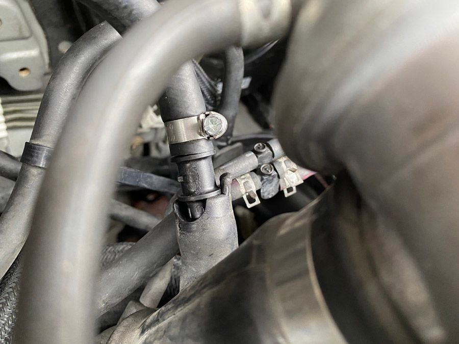

Gates 28609 3/8" to 1/2" reducer connectors.
Gates 28609 inserted into the stock intake hose (1505A304). There is some sort of stock rubber o-ring on the hose that makes this connection air-tight.
Plastic valve cover (1035A999) removed. So has been the stock intake hose (1505A304)'s 90° elbow for the 1/2" (12.7mm) breather.
