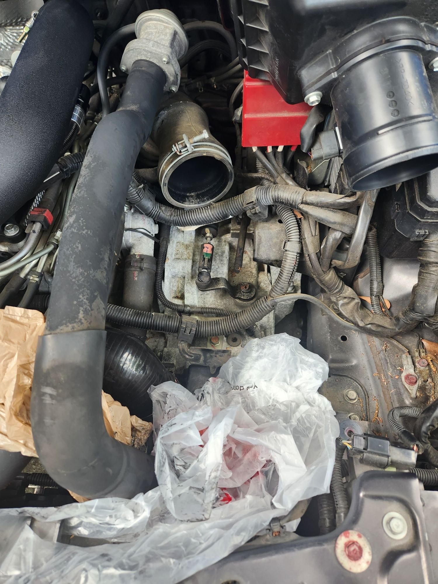

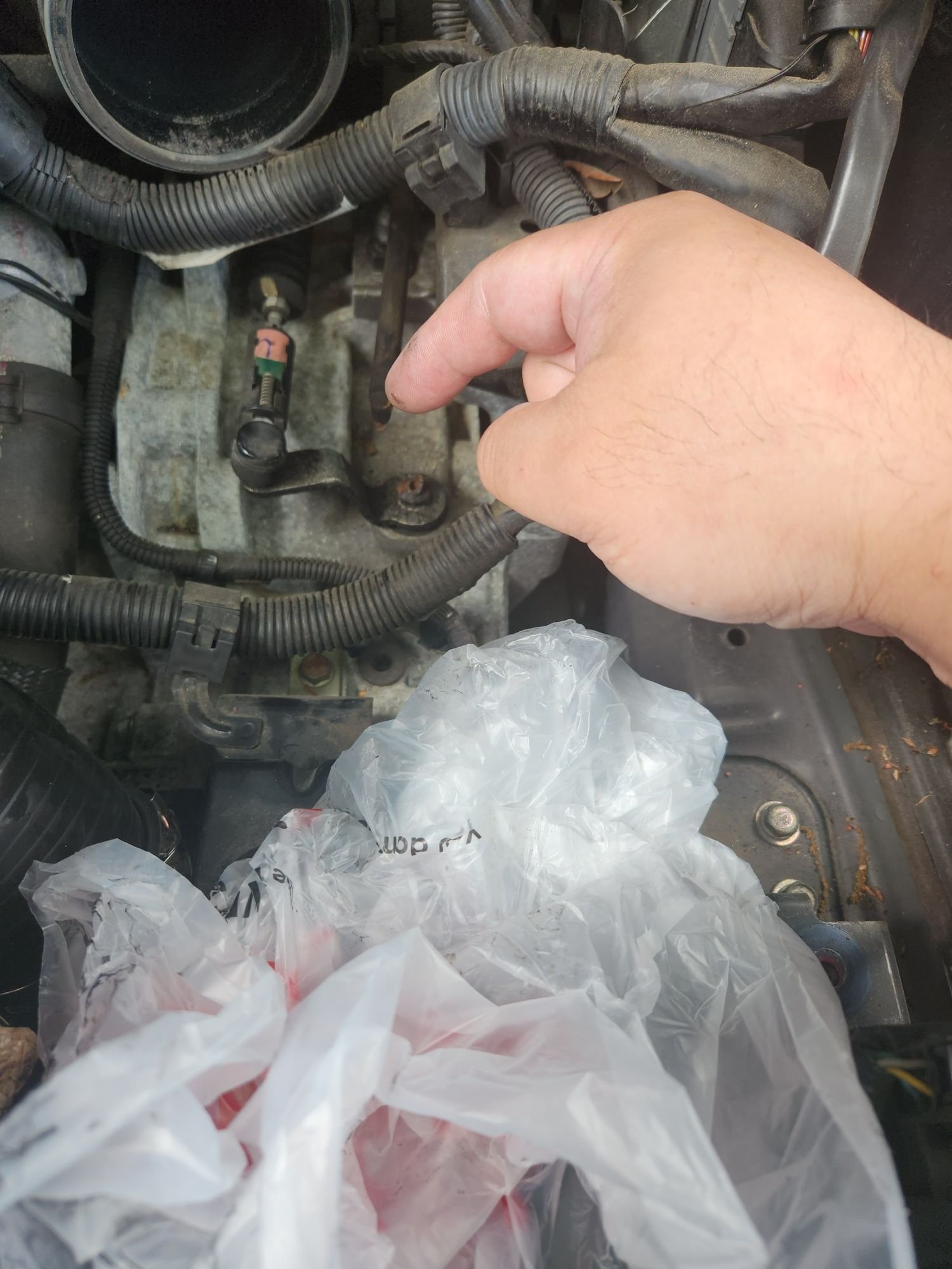

Found this under the OEM intake filter box today.
Can anyone tell me what it is and how to fix it.
I think its a trans vent, I could be wrong.

That is the breather nipple for the trans. Mine looked like that too. It also disintegrated when I tried to pull it out, luckily it didn't fall all the way into the trans, I had to grease a pick and was able to carefully extract the small pieces.
