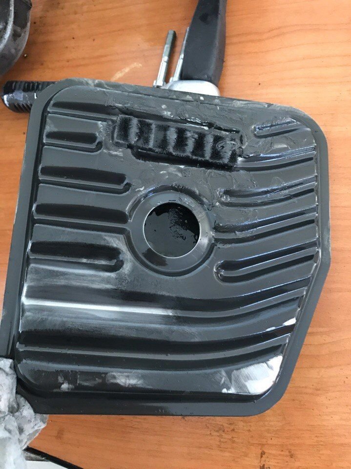

Internal gearbox filter
The manufacturer's factory states that the internal filter lives the entire service life !!! It's a lie and a hoax !!

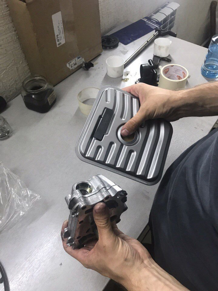

On the oil pump the same sediment

<br/>New filter and rinsed oil pump

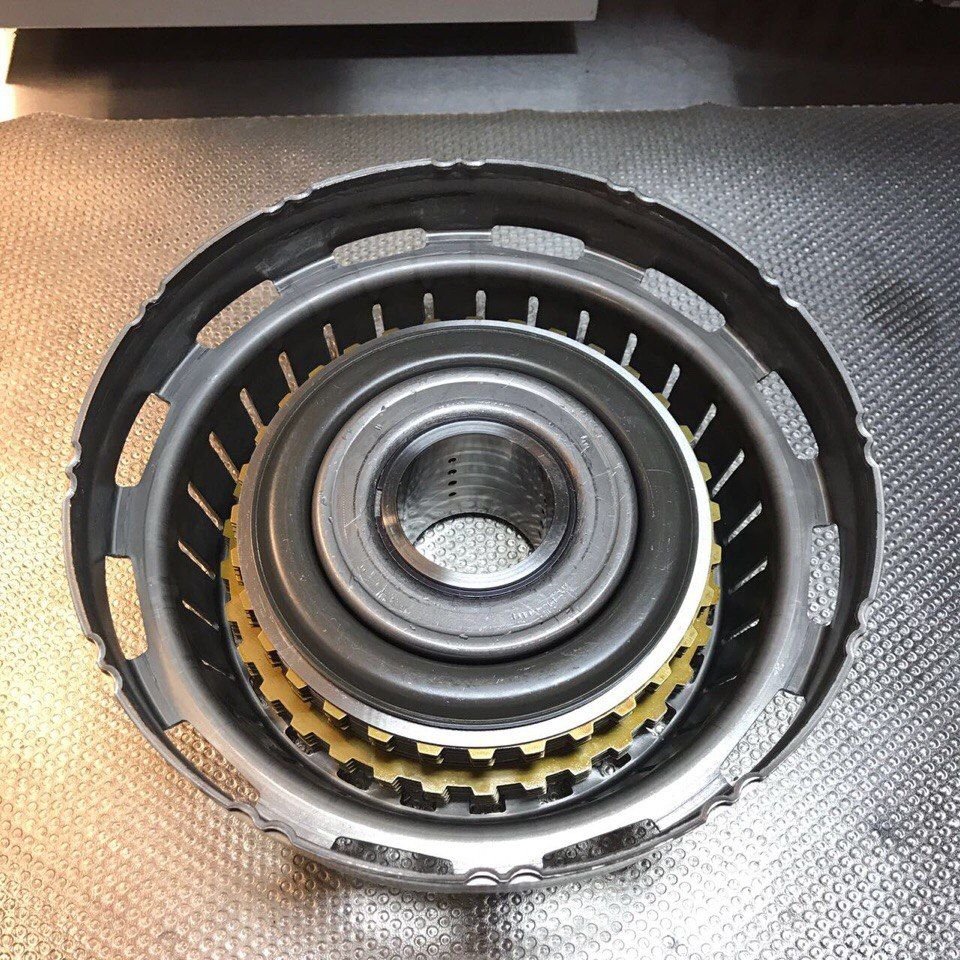

stage 1

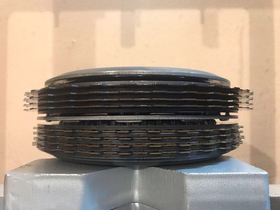

stage 2 (5 disc)

Homemade grip
