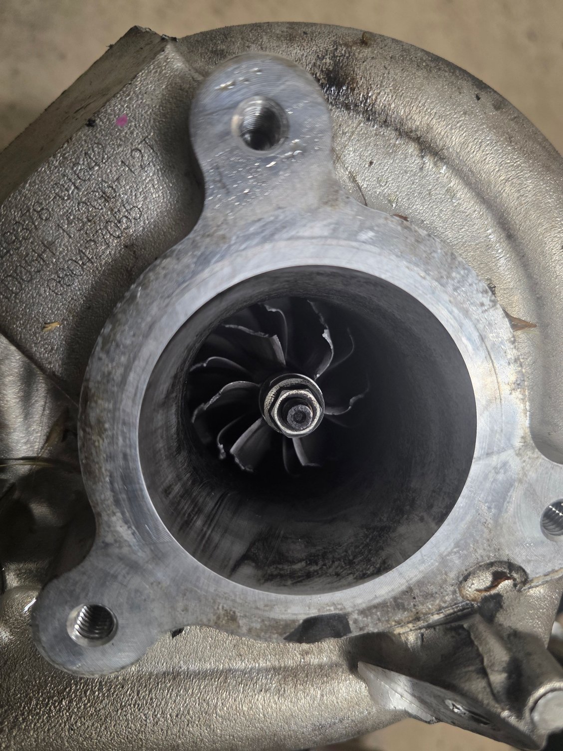

Found the issue!
Originally Posted by Notthisguy
kept looking and tested every individual pipe and vacuum hose and only had a few tiny micro leaks but after replacing the lines, it still makes the whine noise.
I believe now that instead of the transmission, the sound is coming directly from the turbo and traveling down the intake making it sound like its coming right over the transmission.
I am now going to try and find a replacement turbo either second hand or reman and replace the turbo hopefully this weekend or next and will update everyone.
I think i found the issue why the car sounds like it has a super charger, it's has a bad bearing that resulted in the turbo compressor to consume itself.

Oh no! Well I guess I would take this over the trans.. Are you gonna stick with another OEM turbo?
